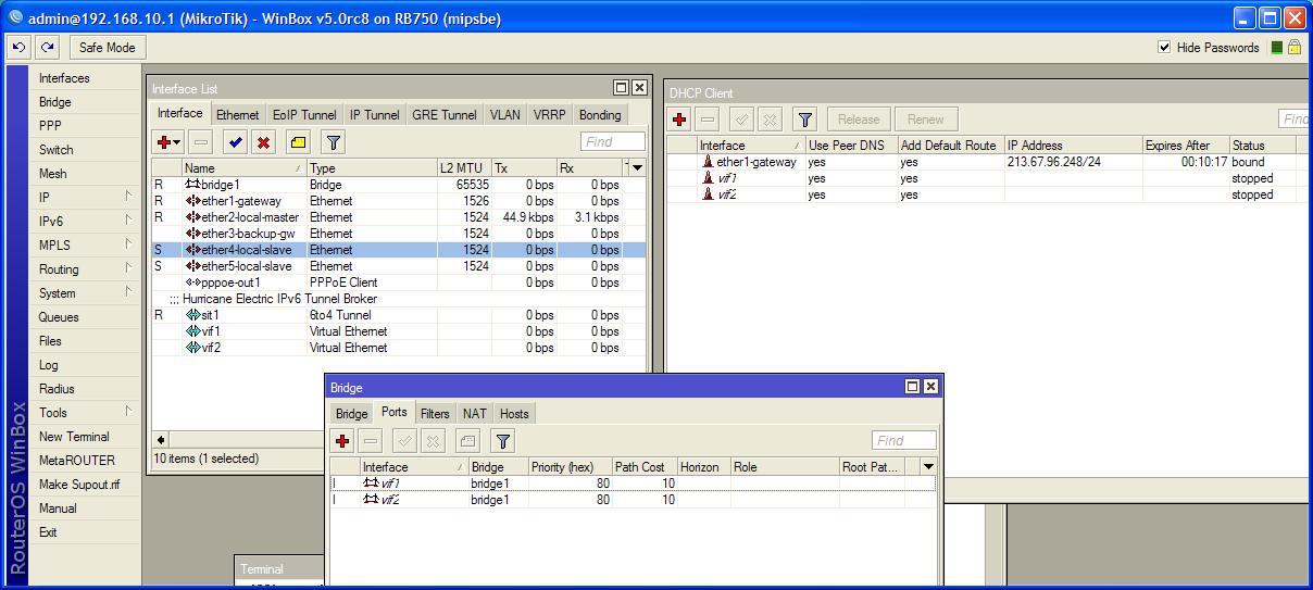

I simply can not figure out how can I acquire more than one DHCP address on a WAN interface.
On ether1, it works perfect… but I need two more public IP addresses (that is possible if I attach the switch directly to the modem).
My main approach was to create a bridge. Add ether1 and virtual interfaces and set dhcp-client on them.
The problem is that the vif interfaces are in status “stopped” and could not find any indication in the wiki how to bring them up.
..also when the ether1 is bridged the DHCP renewal does not work - seems my bridge filter forwards, however I have followed the documentation and forwarding is enabled. ARP (I tried enabled and proxy-arp as well).
Please, tell me what I am doing wrong.
Thank you in advance.
Regards,
Z
PS: I see that on the screenshot ether1 is not among bridged ports, because I have been forced to remove otherwise the DHCP renewal failed :frowning:

Do you have any bridge filter or IP firewall rules active on your WAN port? If so, could you please share those?
The virtual-ethernet pseudo interfaces are designed to operate exclusively with Metarouter instances. They cannot function as standalone interfaces.

I have played with the virtual interfaces and meta routers… I have a feeling that it would work, because I was able to create up to 7 mr-s with 8M memory and each had assigned a vif.
In order to work all vif’-s and the ether1 need to be bridged… but as soon I add ether1 to the bridge it loose the connection :frowning:
