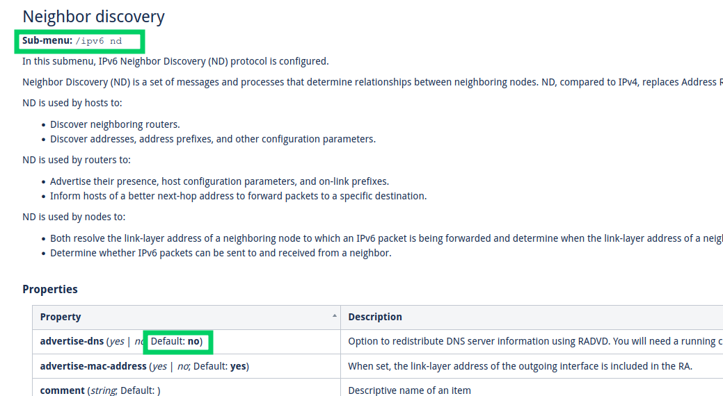

So “advertise-dns=yes” is the suspect? This could really be the reason. I watched the output of “resolvectl” right on bringing the wlan0 link up, I first saw just the single DNS server listed - and only after a few seconds the other addresses appeared. They come from IPV6 neighbor discovery?
Indeed! If I use IPv4 DNS servers for “/ip/dns/servers”, these are not promoted to clients. So it is IPv6 ND.
But then Mikrotik docs are wrong. It states “advertise-dns” is “no” by default. But on ROS 7.13.5 it is “advertise-dns=yes”.

I found in changelog of ROS 6.46:
*) ipv6 - changed “advertise-dns” default value to “yes”;
Mikrotik, well played. Your docs are always on the bleeding edge.
When I set advertise-dns=no, the I dont receive these IPv6 DNS servers anymore.
