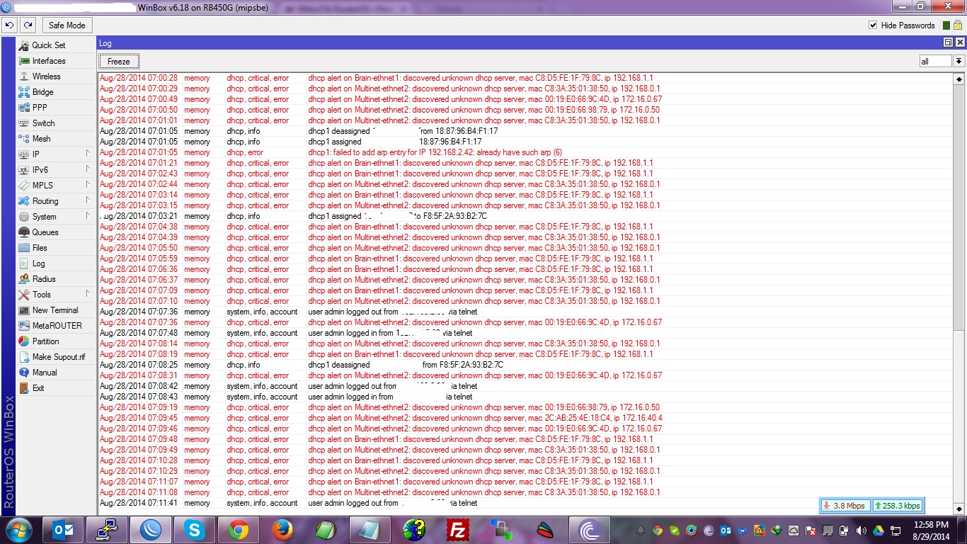

i am getting error in my router log can any one help me to resolve this issue .
i have three different wan interface , the error coming on two wan interface which are “Multinet-ethnet2” “Brain-ethnet1”
i have attached error file please find
Error:
dhcp,critical,error dhcp alert on Multinet-ethnet2: discovered unknown dhcp server, mac C8:3A:35:01:38:50, ip 192.168.0.1
dhcp,critical,error dhcp alert on Brain-ethnet1: discovered unknown dhcp server, mac C8:D5:FE:1F:79:8C, ip 192.168.1.1
dhcp,critical,error dhcp alert on Multinet-ethnet2: discovered unknown dhcp server, mac 00:19:E0:66:9C:4D, ip 172.16.0.67
You have set up a DHCP Alert in your DHCP Server settings.
If these servers are supposed to be running, I guess they are since this is on your wan you can add them to the valid servers list to avoid the warnings.
Or maybe you can switch the alert monitor to your lan. The wan port should be monitored by your isp for this kind of problems.
Thanks for your reply .
you mean i need to add my both wan interface MAC address in valid servers field?
Not your mac addresses of wan interfaces, but the mac addresses you see in the alert message.
thanks for your support this issue is resolve now .
