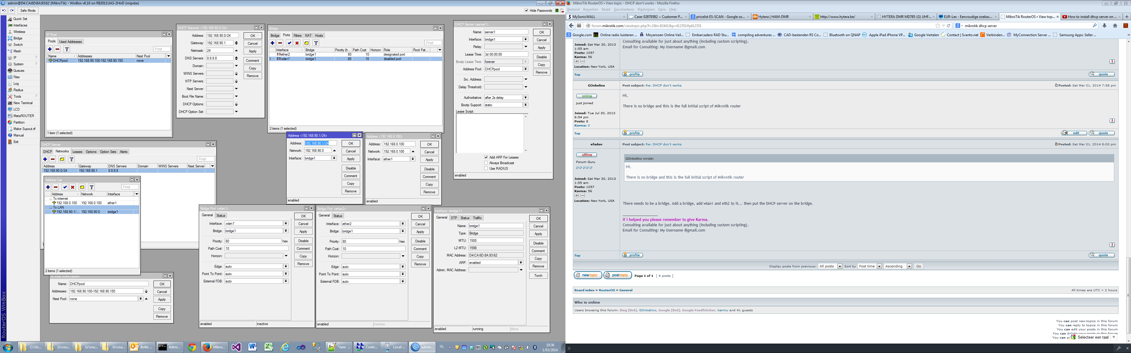

    See Script and picture:

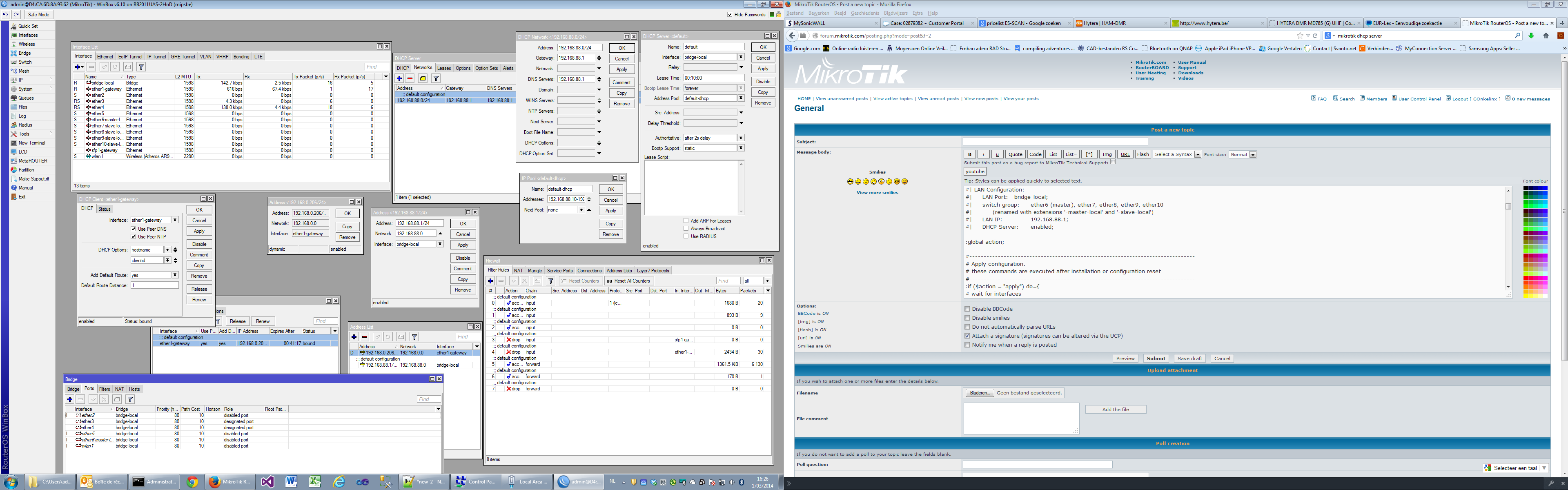

See picture and script

The pictures are worthless. I can’t read anything on them.

wn(59),NETBIOS-Name-Server,Unknown(66),Unknown(150),Unknown(2),Unknown(151)
21:08:15 dhcp,debug,packet dhcp_server_lan_sw1 sending offer with id 1550153034 to 255.255.255.255
21:08:15 dhcp,debug,packet ciaddr = 0.0.0.0
21:08:15 dhcp,debug,packet yiaddr = 192.168.88.101
21:08:15 dhcp,debug,packet siaddr = 192.168.88.1
21:08:15 dhcp,debug,packet chaddr = 00:0E:08:D3:A2:21
21:08:15 dhcp,debug,packet Msg-Type = offer
21:08:15 dhcp,debug,packet Server-Id = 192.168.88.1
21:08:15 dhcp,debug,packet Address-Time = 259200
21:08:15 dhcp,debug,packet Subnet-Mask = 255.255.255.0
21:08:15 dhcp,debug,packet Router = 192.168.88.1
21:08:15 dhcp,debug,packet NTP-Server = 91.207.136.55
21:08:15 dhcp,debug,packet Domain-Server = 192.168.88.1,8.8.8.8,195.130.130.3
Now, since I don’t understand which is your current config, let’s talk about the first one (the picture does not show that one, but one with a bridge).
Your DHCP server works ONLY on interface eth2, as configured..
So, to get is working on all LAN ports, you need to configure ALL your LAN interfaces to use interface ether2 as master (do this under interfaces, double click each ether from 3 to whatever you need, go to the general tab and set Master Port to ether2).
Or do it by CLI:
set ether3 master-port=ether2
set ether4 master-port=ether2
set ether5 master-port=ether2
In your export there’s nothing doing this…
Where is 192.168.88.1/24 assigned? Is there a dhcp server issuing those ips? All those offers are for 192.168.88.101.
:laughing: That’s another good question!
If I look at export, to the pictures and to the log, it seems they are coming from 3 different routers.
