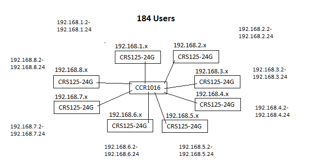

I have 175 users in a network, all on cable and connect directly to switch. When I have any problem witch cable, it´s so dificult detect the cable on Switch. If I could do fix the Ip-user with the port-fisic, I resolve this problem.

Now, I only have this idea:
On each CRS125-24G:
One dhcp-server each port/interface, one IP per pool with reply-arp only activated.
It´s a lot of work and it´s not elegant way to do it.
I hope a better way exist from CCR1016, just only one dhcp-server!!.
