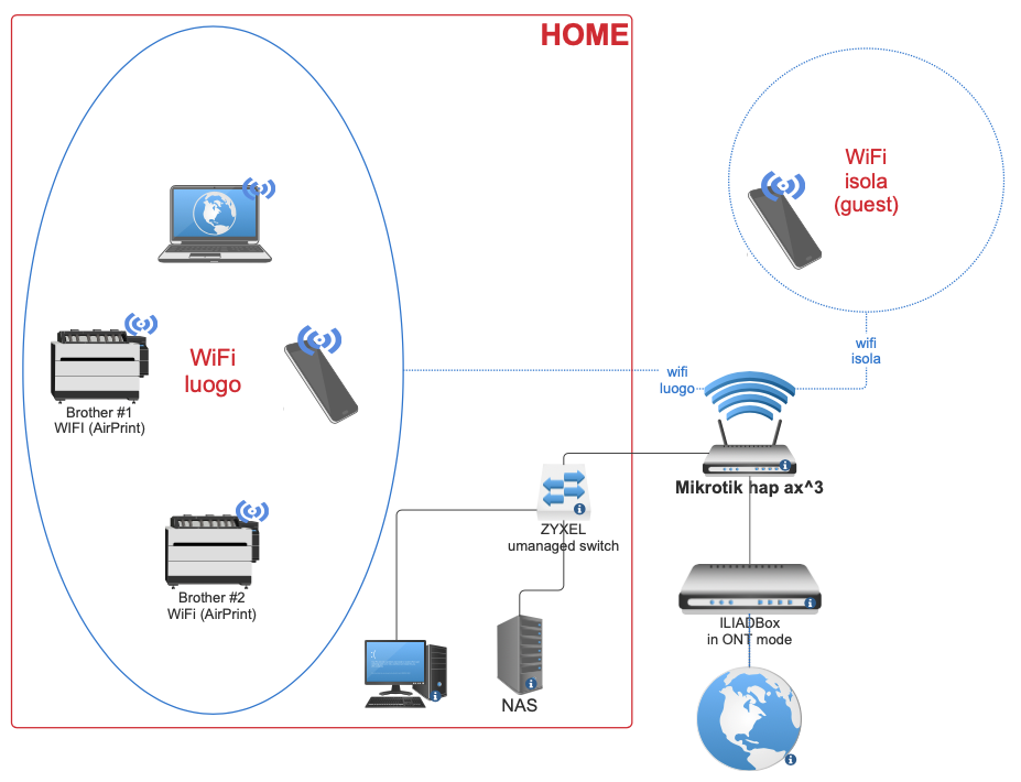

DHCP is offered but not bound to Brother printers only
I set up a separate isolated guest WIFI on my hAP ax^3 and it seems to work. All devices connect, guests don’t see the home network and vice versa, everything works BUT only two devices refuse to connect — and both of them are Brother printers. The IP acquisition status does not go beyond ‘offered’.
I’d say I’m a bit of an advanced user and after digging through many forums I’m stumped, help please :slight_smile:
What could be the problem?
Thanks in advance.

Can you post some kind of your connection scheme, like are those printers wireless or wired and what ports/networks do they use, is there a switch (managed or dumb) in-between and so on
True. But if frame-types is set as what @holvoetn wrote in quoted quote, then bridge doesn’t appear as untagged member of VLAN 1 if you execute /interface/bridge/vlan/print and that’s what counts (this is simillar to setting speed on ethernet port to anything while auto-negotiation is set to yes - it gets ignored).
Sure.
Here is it.
The older printer, wired or wifi?
WiFi
Yes, I didn’t write that at the beginning, sorry — all Brother printers are WIFI only.
