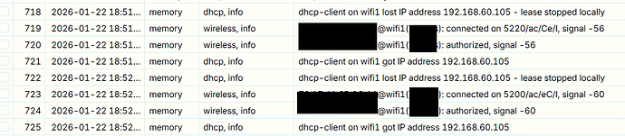

The strategy is, local network in the eth1 and wan on the wifi1 which is the 5ghz iface, with masquerading we make the NATting, we set a DHCP client on wifi1 iface but every time the mkt roam between two AP the mkt itself release the ip lease and ask again when roam is completed.

Is any way to not lose the lease when the station roam between APs?
