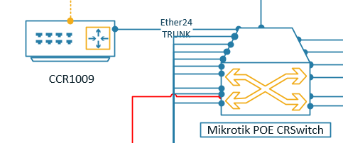

DHCP lease unsuccessful after upgrade to 6.48
The DHCP server was happily giving the lease to the switch. I did not change any configuration, only upgraded the CRS from 6.47.7 to 6.48 and the DHCP server lease cannot be given successfully to the switch any longer.
To confirm, everything was working fine, simple upgrading the switch caused this issue.
Both CCR and CRS is running latest stable 6.48
Router: CCR 1009, RouterOS 6.48. Firmware also upgraded
Switch: crs328-24p-4s+rm RouterOS 6.48. Firmware also upgraded
Relevant Config on router: Simple DHCP server running on vlan 801.
Relevant Config on CRS-Switch:
add frame-types=admit-only-vlan-tagged ingress-filtering=yes name=bridge vlan-filtering=yes
/interface vlan
add interface=ether24 name=vlan801 vlan-id=801
add bridge=bridge comment=defconf interface=ether24
Ether 24 of the CRS is connected to ether7 of the CCR
So, the CRS is acting as a switch, all ports added to the bridge and tagged/untagged as per config

I have configured my VLANs in a different way, I configured all VLANs on the bridge instead of on the interface:
Thank you for the reply.
For VLAN config I have followed this:
and this:
From my current understanding, this is a better way to VLAN. Correct me if I am mistaken.
Basic idea is: when bridge vlan-filtering is enabled, then VLAN interfaces have to be configured off the bridge, not off member interfaces.
If VLAN interface is defined off a slave interface, then behaviour is slightly undefined (and might change as well between ROS versions). It may have worked “in parallel to bridge” previously but may have broken with new ROS version. Anyway, in this case bridge VLAN filtering doesn’t apply to traffic via that VLAN interface at all.
BTW, both wiki manuals and the tutorial linked by @erlinden are talking the same language. So I suggest that you go through the tutorial (it has some great examples which should help you understand VLAN config) and reconfigure your CRS328 accordingly.

Could you give me a deeper explanation why you say " Anyway, in this case bridge VLAN filtering doesn’t apply to traffic via that VLAN interface at all." ?
So, I just tested the exact config on a 3011 and a hap lite, and it works as expected. But why does the exact same config on the CRS not work?
I cannot connect to the CRS even via RoMON (romon is enabled on both the CCR and CRS)
CRS3xx offloads bridge VLAN settings to underlying hardware, while the rest of devices implement everything in software. It is possible that pure software implementation is more forgiving than hardware implementation.
You have plenty of VLANs configured in proper bridge-vlan manner. So why don’t you want to do the same for VLAN 801? Move vlan interface vlan801 from ether24 to bridge and configure appropriate vlan settings under /interface bridge vlan (e.g. add bridge=bridge tagged=bridge,ether24 vlan-ids=801) and you’re all set.
Thank you for this excellent advice. The missing part was that I did not think about tagging the bridge itself. Now in my lab its working. Just need to try to get access to the CRS perhaps via console and then will test it
This solved the issue, tested and working. Best wishes!
