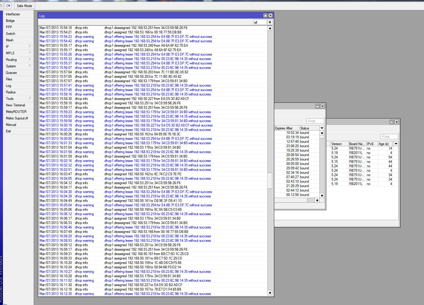

holy moly, i’m going to lose my mind. so many support calls from this client this week, I have this gateway(rb2011 rackmount)
that feeds 7 rb751u’s directly off the ports ether2-9 on a bridge. I am seeing nothing but ‘DHCP offering lease without success’ errors.
I had one guest who had a PC laptop,ipad and phone and all of then sat in the lease pool as ‘offering’ state and then would switch to ‘bound’
and then back to ‘offering’ over and over and over. nuts!
I took a picture in hopes that someone can help me resolve this for once and for all. I have seen these errors like 3 years ago but never warranted

me too seeing this message in my log.what is this error is actually??

thanks for the feedback, what you can’t see is that this is a /23 network, this is why you are seeing the current range of addresses. not your fault. that said I even have these same
issues on /24 network locations. sadly. Aside form that I don’t see how changing the dhcp server on the ethernet ports will help, mikrotik generally suggest to use bridges where you can.
