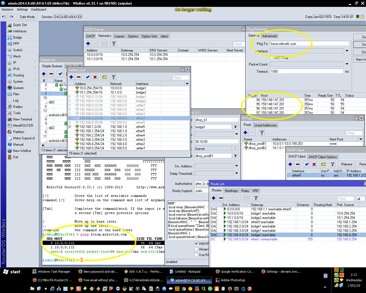

i tried to ping in ‘terminal’ window :
 ping forum.mikrotik.com
its replied not from forum.mikrotik.com real ip address, its from 1 or random of dhcp user
  SEQ HOST                                     SIZE TTL TIME  STATUS
    0 10.0.0.131                                 56  64 2ms
    1 10.0.0.131                                 56  64 2ms
    2 10.0.0.131                                 56  64 2ms
BUT
winbox > tool > ping, → replied from forum.mikrotik.com real ip address
w/ or w/o script : problem still there …

i figured it out … its beacause … :
[u]some device/u with undifined (or blank) host name registered in DNS Static will make this error the router
even i tried force all connection to wan connection (in my case is : ether5)
