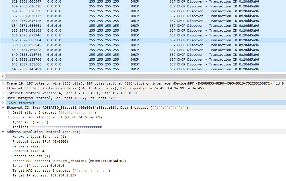

So, I asked the router to send me packets transmitted on the ether2 port and related to the mac address of the device 00:60:34:36:AD:61 to my wireshark instance in my computer.
What I see is the device sending DHCP Discover requests trying to re-obtain an IP:

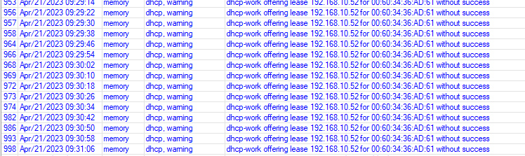

And I can see the DHCP server on the CCR1009 claiming it is trying to provide the last held IP to the device:
The question is: Why can I not see the CCR1009 sending out a DHCP Offer packet on ether2 to 00:60:34:36:AD:61? The wire is pretty much irrelevant if the DHCP Offer reply packet does not leave the router.
Yes, some sniffer packets could be lost. But surely not all of them and not just when the device has trouble obtaining an IP. So this does not seem likely.

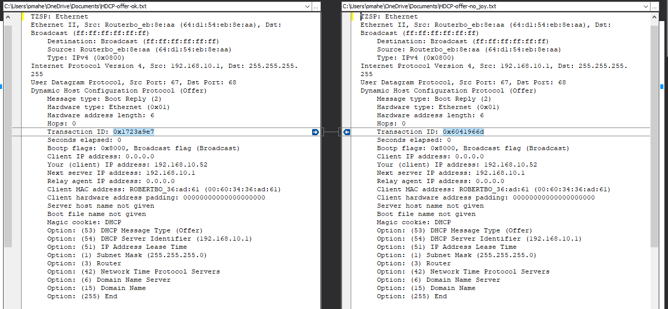

Ah, I discovered why I cannot see the replies from the DHCP. It is because Replies from the HDCP server are sent to a broadcast MAC address. So this can be fixed by adding the router’s MAC address to the sniffer filter and keeping the direction filter set to any.
Now I can see a hopeless Discover-Offer loop. So, yeah, it could be the wire. :laughing:
But. A wire would provide random intermittent results. Otherwise, I can not explain why only a reset of the device would fix it. If this particular pattern would cause the particular EM interference… then the DHCP should not work in most cases. But not every time - until I reset the device, after which it works fine for days.
The DHCP offer packets from the router are identical, according to my Eye MK I, and my computer agrees. The only difference is the Transaction ID (and that is expected):
Just that after the reboot, the device responded with a DHCP Request packet… And before the reset, it kept sending another DHCP Discover.

So to my second question, I do not have a definitive answer. But thinking about the situation… Let’s say that a packet would indeed get corrupted by interference and unfortunately, that packet would be the DHCP lease offer from the router. The device discards the corrupted packet and sends out a new HDCP request packet. To which the router responds with the bit-for-bit identical DHCP lease offer that for some reason now always gets corrupted and the device is caught in the HDCP request-offer loop without ever ack-ing the offered IP. I would think such “reliable interference” caused by the UTP cable to be quite unlikely. So, there is probably also something wrong with the network stack on the device. Perhaps the interference messed up the receiving capability of the device altogether.
