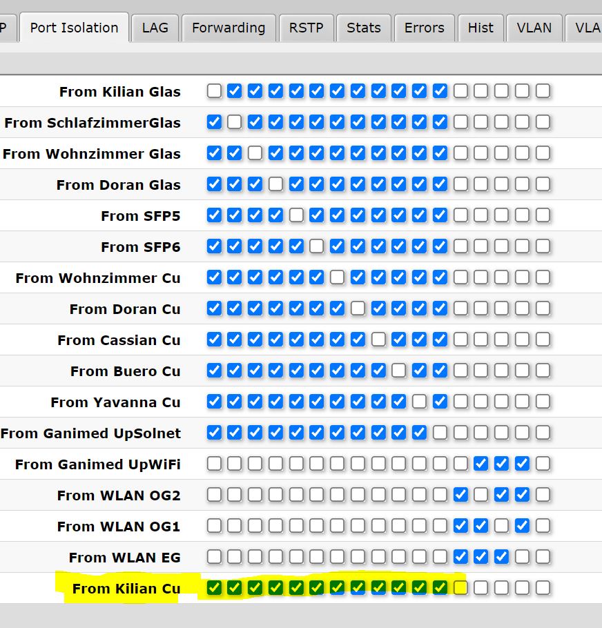

I run a CRS 317 with SwOS 2.13. It has a lot of SFP+ Ports and that lonely ETH/BOOT at 1GB/s.
I would like to use it as a normal 1G Port and I thought it will work… I was wrong.
The ETH/BOOT is called “Kilian Cu” and in the “port island” of most other ports of that switch
If I plugin a computer the LEDs turn on. I see that SwOS Link tab turning to “link on”. I see the host’s mac address under “Hosts” BUT I do not get an IP over DHCP.
There is nothing special configured for this port. It all looks like the SFP+ settings I use. I only use VLANs for the smaller island of ports and ETH/BOOT is not part of it.
DHCP & PPPoE Snooping is set to trusted for all ports. Is there a magic setting somewhere that keeps me from using the ETH like a normal port for a client?
I am lost… any host gets immediately an IP if i use a random other port.
Regards Marc

there is a DHCP Server behind an GanimedUpSolnet and all happens in default VLAN 1. For all SFP+ ports in that “square” in “Port Isolation Tab” I get IPs over DHCP by that server.
Only ETH/BOOT seems to be different. It is similarly configured in all menues I know. For all other ports it did the magic, for ETH/BOOT not.
ETH port is connected, 1Gb/s listed, mac address is listed but no DHCP reaches the client.
VLANs are only used to get 3 WLANs through one cable to the accesspoints. That is the different smaller square… there the DHCP is behind GanimedWifiUp … at the end the same Server with second glas fibre port. As well here everything works..
