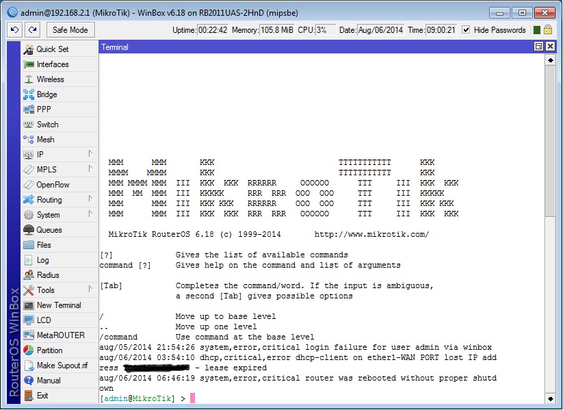

I got a DHCP leases problem to my WAN. Error on below,
Everytime this happens, my RB hangs and affecting the LAN. Is there any work around for this? Atleast, maybe a script that will release/renew the WAN every 4hours. Need to do a power on/off just to bring it back.

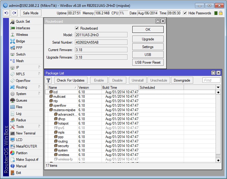

My RB is on the latest updates and firmware.
Appreciate your response on this.
