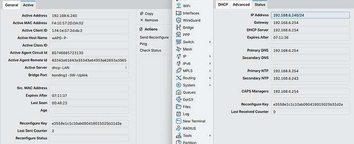

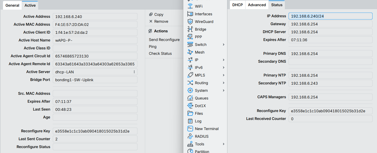

When you open the lease entry on the server, does the value in the Reconfigure Key field (Active tab) match the value in the Reconfigure Key field (Status tab) of the DHCP client on the other router?

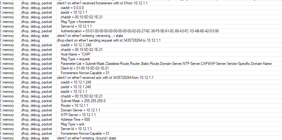

I did further tests with DHCP Snooping enabled and between two CHR instances, and there was no different. FORCERENEW still works.
Do you have something else between the two devices that might reorder the DHCP options / insert new ones? It's not DHCP Snooping because that only inserts Option 82 on packets going from client to server. The messages from server to client (where the HMAC-MD5 calculation applies) is not modified by the DHCP Snooping Add Option 82 setting.
Is the same.
You could try the newest 7.24rc1 version, it has a fix related to forcerenew
