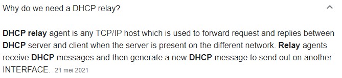

Thank you. Everything is working fine now. However, I can’t understand, when DHCP Relay should be used.
DHCP relay is when the DHCP server itself is not reachable by the client, is on another (routed) network.
Here DHCP server and clients are all on the same (bridged/switched) L2 network.
