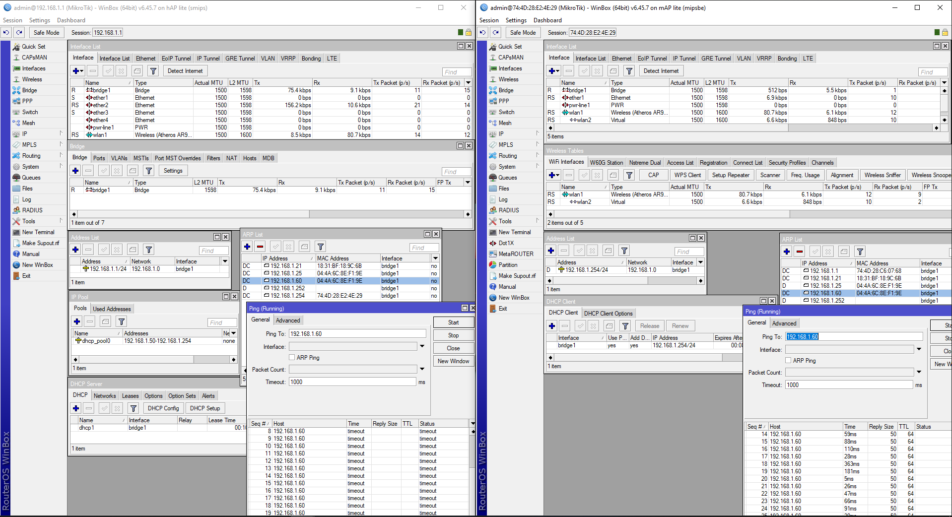

Hello. I need some assistance with the following issue. I have one mikrotik Hap Lite and one Map Lite. I have configured the Hap lite to be a dhcp server and ap and the map lite to be dhcp client and ac bridge. I managed to connect my phone to the map lite (client) and it got an IP which I could see in the ARP list in the hap lite (server). But I couldnt ping the IP from the hap lite but I could from the map lite. Eventually I want to connect a device via ethernet to the map lite with a static IP and have communicate with devices connected to the hap lite via ethernet. My confgurations are attached. Is anything wrong with what I have done there?
How exactly are both Routerboards connected? Over wireless?
