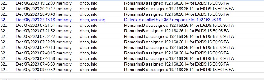

Hi all. Suddenly my HAP ac3 DHCP server seems to constantly assign-deassign wifi devices.
Any suggestions ? Didn’t have that kind of problem before but the last days is constant.
I use a HAP ac3 (Main Router v6.49.6) and a HAP ac2 (as AP in bridge mode with LAN connection to the first, v6.49.6).
Wifi Devices about 60-65.
Any help would be really appreciated.

In my case I have only 2 DHCP servers on a subnet (VLAN) , and one of the devices was flapping between the 2 DHCP servers. The DHCP servers are full split scope, but if they respond alternatingly the client gets a lot of NAK , and disconnects from the wifi. (Don’t know what comes first. The flapping was seen in the wifi assigns-deassigns. Debugging showed the DHCP NAK.)

Unfortunatly … didn’t work as expected. Both DHCP servers assign conflicting IP addresses from the identical pool (same IP address to different devices) . One of the DHCP servers is authoritative the other even never. Didn’t help. Wifi devices are often off-line. When both are on-line conflict can be detected.
And by the way the IP address deassign/assign flipper is back.
