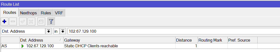

The problem we are experiencing is that when the DHCP server has issued the customers CPE (also mikrotik) with an IP lease it doesnt add a route back to the customer in IP => Routes
add dhcp-option-set=“single static ip dhcp” disabled=no interface=“Static DHCP Clients” name=dhcp2 use-framed-as-classless=no use-radius=yes
Please see the attached image where i have to add these routes back to the customer manually.
Is there a way to script this in the DHCP server or I’m i just missing something?
