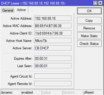

I have a problem with a DHCP Server. It keeps offering two addresses to something that no longer exists on the network. I am unable to remove the address from the DHCP Server Leases Tab or the ARP table. Is there a method to acomplish this?

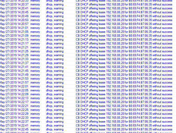

I have attached a visual of my problem. The MAC and I/P addresses do not exist on the network yet the DHCP Server keeps offering and loading up the log file.
Those MAC addresses are assigned to Mikrotik. What are the log messages?

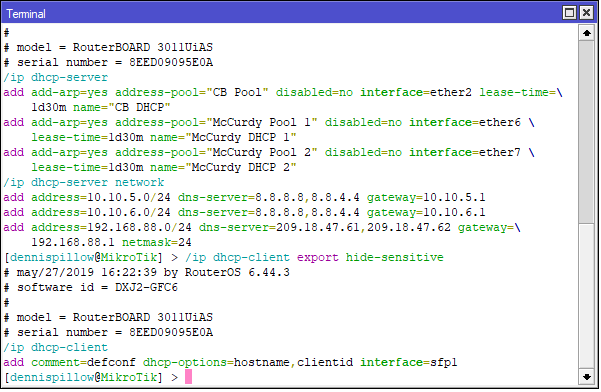

What does the following pasted into a terminal window on the mikrotik show:
:foreach i in=[/interface ethernet find] do={ :put "$[/interface ethernet get $i default-name] $[/interface ethernet get $i mac-address]"; }
Your config, or certainly the DHCP part of it (using /ip dhcp-server export hide-sensitive and /ip dhcp-client export hide-sensitive ) would be useful too.
Here is the result of the server and client request
I’d post the output of /export hide-sensitive with any public IPs, etc, obsfucated.

OK. Naming your bridge “Static IPs” is somewhat confusing - it appears to actually be your WAN, and it is included in your LAN interface list which will allow more external access to your Mikrotik than you may wish for.
The /ip dhcp client entry for sfp1 is the cause of your DHCP requests, and as it a member of the bridge containing ether3 the address used could easily be that of ether3 (inherited by the bridge), rather than the interface itself. As your WAN IP is static just remove the DHCP client.
