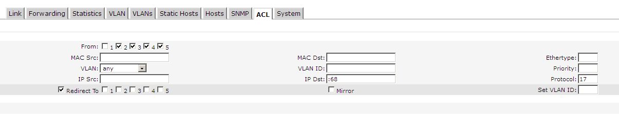

IMO rb250gs could have only rouge dhcp block function, notification is not necessary.
Just i.eg. port 1 trusted, 2-5 untrusted and thats all, as simple as possible.

IMO it can be done because Dhcp snooping is L3 function like ACL list in currently SwOS.
I did some “researches” and using ACL can do the trick:
“Signal” cable at first port, clients at 2 - 5.
