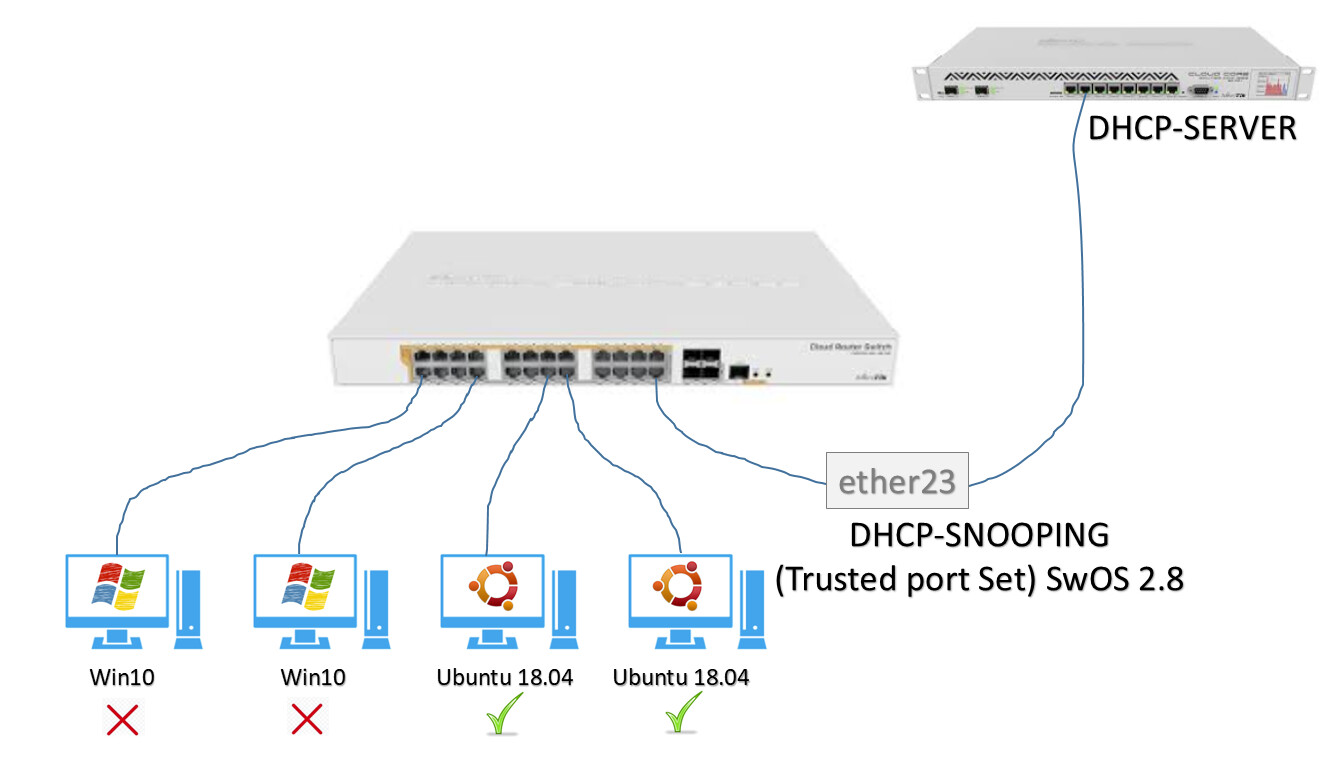

I setup the device with network diagram that i attached in the topic, my problem i configured dhcp-snooping on ether23 when i connected the cable to other port i can not get ip address form dhcp-server if i use ms windows but if i test with ubuntu i can get the ip address, What is wrong ? advice me please.
Do you have DHCP Snooping enabled on the end device ports of the switch (ports 1, 7, 13, & 15 if I counted right)?

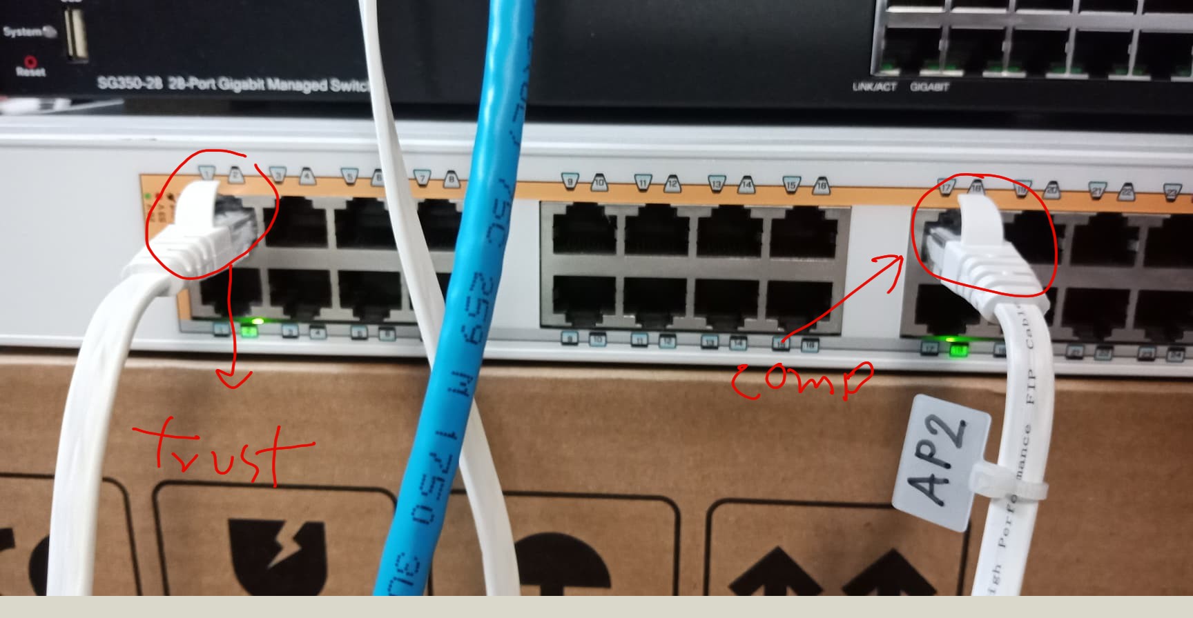

This is my lab .
Port 2 = Trusted port
Port 18 = Untrust port
my labtop can not get ip from dhcp server
What wrong ? advice me please.

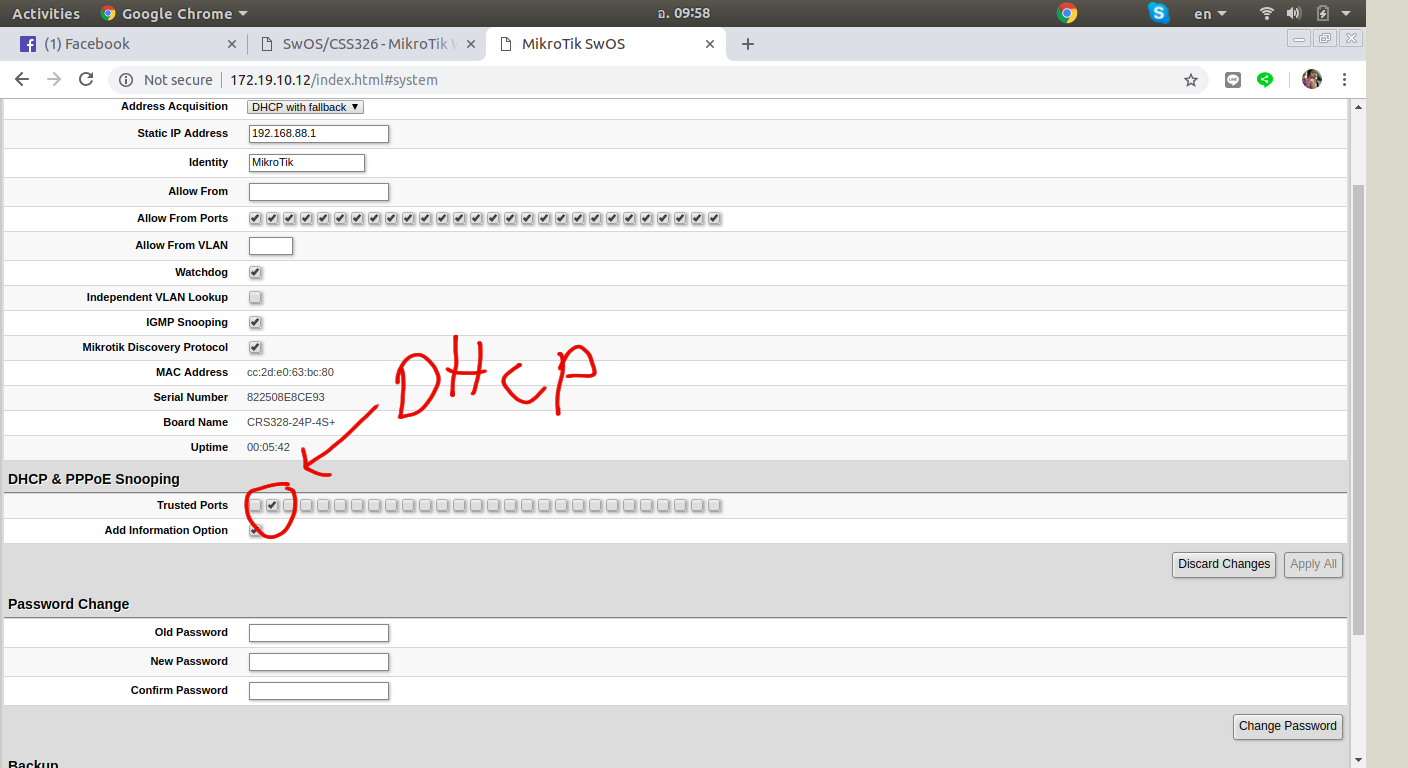

My test case switch between trusted & untrust port.

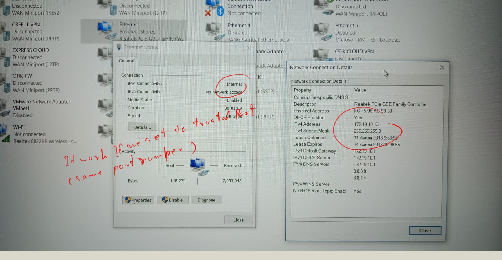

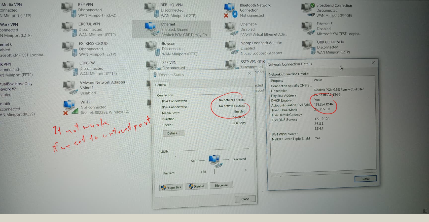

I connected the DHCP server to port1 and checked Trusted, and, for all other ports, unchecked Trusted. My Windows 10 laptop didn’t get an IP address from DHCP server with this configuration.
If I check Trusted for the port the laptop is connected to, I do get an IP address immediately.
I think this isn’t the intended behavior.
I have to mention that I use VLANs, and the DHCP server is on port1 VLAN 500 tagged, and the Windows 10 client is on port24 VLAN500 untagged. I didn’t tested this without VLANs.
