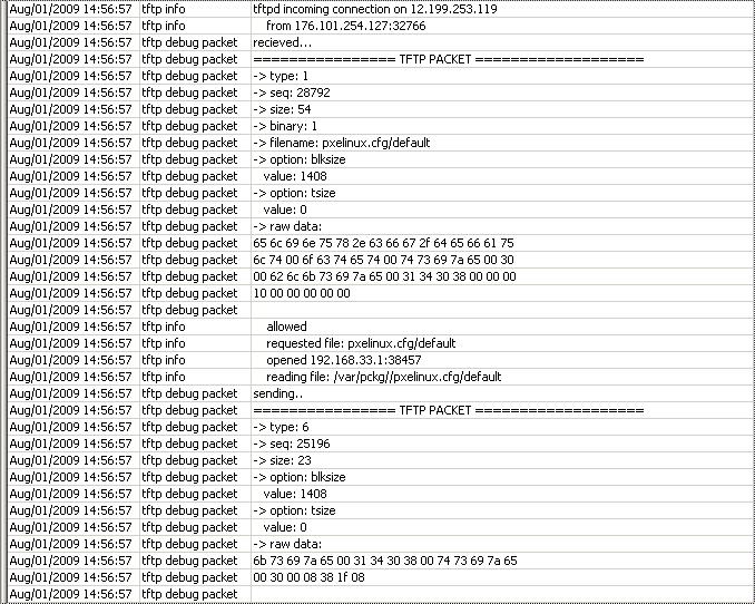

Here is a capture of the relevant log entries. The client IP is 192.168.33.252 and Router IP 192.168.33.1.
I’m not sure why incoming connection from is showing a weird IP. I have no idea who’s IP that is. Mikrotik, could you also explain this while you’re at it. Thanks.
