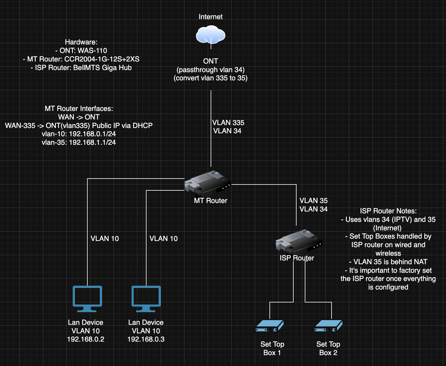

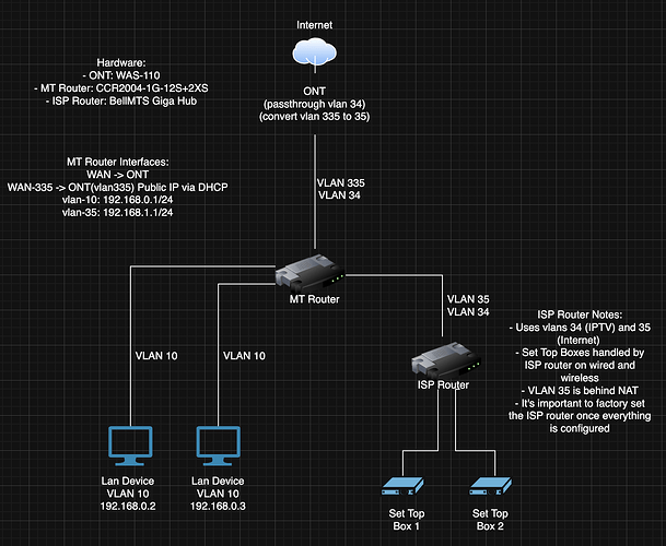

My ISP provides a modem/router and some tv set top boxes. In my case I have bypassed their modem for internet, but would still like to get the set top boxes functioning. My ISP utilizes 2 vlans for the following services, 34 for TV and 35 for Internet. I currently have internet functioning through a vlan 35 WAN interface behind my local nat, but haven’t been able to get the ISP router and set top boxes working.
What I’m attempting to do is connect my ISPs modem/router to my router via vlan 34, which should passthrough to the wan interface. I tried to create a second bridge (bridge-wan). and add both the wan and eth port the ISP router is on. Though when I do this, for some reason when the ISP modem requests an ip with DHCP, the offer never makes it to the ISP modem. I do see that it’s received by the WAN interface, but that’s where it stops.
Here is a crude diagram of what I’m attempting.

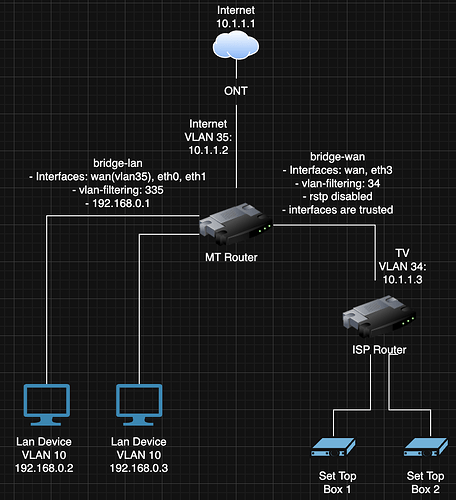

Thanks for all the feedback. I did discover why the DHCP offers weren’t making it past the WAN interface. I had a vlan 34 interface on the WAN interface which shouldn’t have been there. The ISP modem is now getting an IP and is working. If anyone is interested, I may show an updated diagram and list the hardware I’m currently running when I have time.
Yes please!!

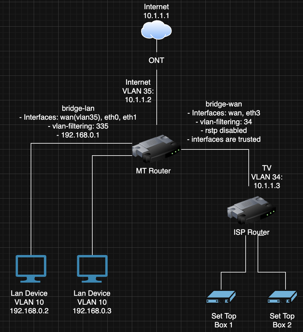

This is what I ended up with, hopefully this updated diagram makes it a bit more clear. Also, one change from before is I’m using a single bridge this time.
