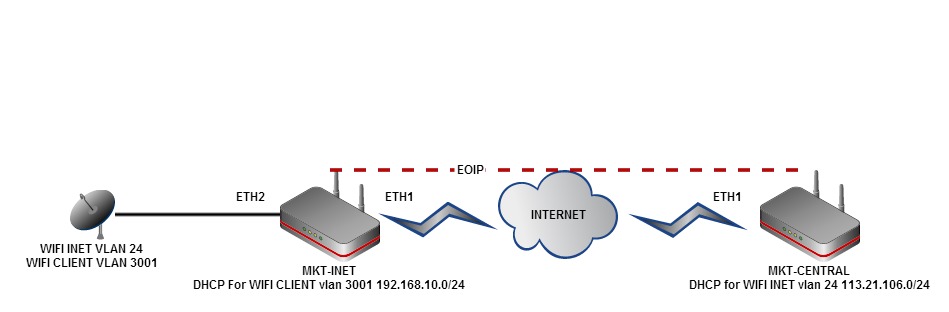

EDIT : added a quick picture of my network, and the configuration
I m having some issues with my network configuration.
Let me explain
I got a mikrotik central, calling it C
I got another one on a distant site, calling it D
And i got a wifi ap working with vlan, calling it W
On W i got two wifi, with two different vlan, 24, and 3001
W is on the ETH2 of D
C and D are linked via an eoip tunnel using the ADSL
C is supposed (and it works) to give DHCP to everyone on wifi with vlan 24
How did i do ? (i won’t detail mkt C conf, the problem is coming from D)
First, created the eoip link. Then created a VLAN 24 on the eoip tunnel on side D. Then created a bridge on D, and bridge ETH2 and VLAN24
It’s working perfectly.
What i want is that people connecting on the wifi with 3001 tag, get dhcp from a local dhcp on the mikrotik D ?
Could you explain me please ? cause i tried a lot of different things and nothing is working…
Thanks a lot
