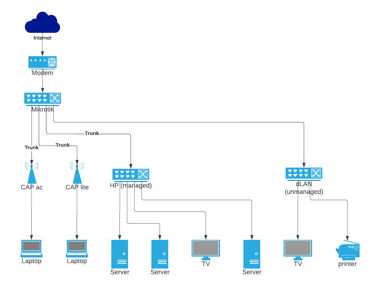

Hello everyone in my first topic,
I try to setup my small network with some VLANs. In every VLAN should run a DHCP-Server. Devices that have a wired connection at the managed switch are getting an IP. If I connect to the Wifi the device don’t get any IP. Please help me to get started and to understand the problem and how to run the DHCP-Server on all interfaces.
Greets
On a quick look, I don’t see anything that jumps out at me as a problem. Note that I have never used a bridge in RouterOS so there could be something I missed there. I also have never used WiFi in RouterOS. My current best guess is something in the WiFi is not configured correctly for what LAN shows up on the WiFi - just a guess.
BTW, for a new person, you did a great post. You included a network drawing and at least an extract of your config (and even got that into a code block). You did however not tell us what hardware is involved, nor ROS version. Trust me, you did FAR better than most people for your first post.

Involved hardware:
Modem: AVM Fritzbox7490
Router: Mikrotik5009 ROS: 7.2.3
AP: Mikrotik CAPac ROS: 7.2.3
2nd switch: HP 1810
