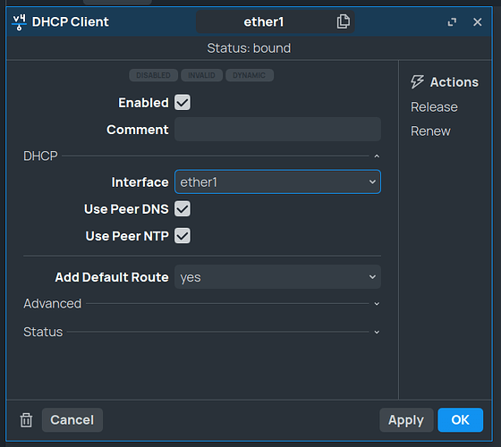

I understood earlier in your posts that your "ether1" is your ISP "uplink" AND if you pull out the cable out of your Mikrotik router and put it on a PC it receives via DHCP a 192.168.88.x IP and Internet works.
PC connected to Mikrotik via ether2 and ether1 is my WAN. By the way, the LAN which going to ether1 as WAN is coming from a Switch, and when I connect this cable directly to the PC from the Switch I get Static 192.168.88.103 IP address/Gateway: 192.168.88.1. So I can access the internet.
So it is clear that 192.168.88.1 IS the gateway your Mikrotik also has to use via "ether1" (WAN)
...but wait...why don't you simply make "ether1" a "DHCP-client" It seems something "upstream" is providing IP + Gateway information. (because you tested with PC and it worked)
So go to "IP" -> "DHCP Client" and "add" interface "ether1" as DHCP-client.
Then make sure "used peer dns" and "add default route" are selected.
Then see what happens IF you automagically get also a 192.168.88.x IP on that "ether1" port.
It is worked. Thank you very much!
