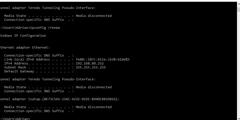

For some reason, whenever I connect various windows 10 computers using either a wire or wireless they don’t get an ip address or the default gateway doesn’t show up automatically, however, if I type it in manually it works. This is an issue with laptops as this is a frat house and people need to be able to connect to the university wifi and coming back home without having to play with settings. I have googled around but can’t seem to find the issue let alone a solution if maybe someone could help me out I would greatly appreciate it! Picture of what happens when I don’t manually set the IP and Defualt Gateway attached.

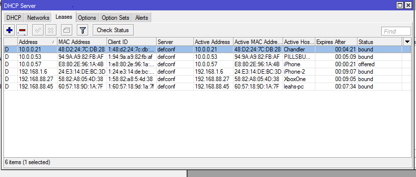

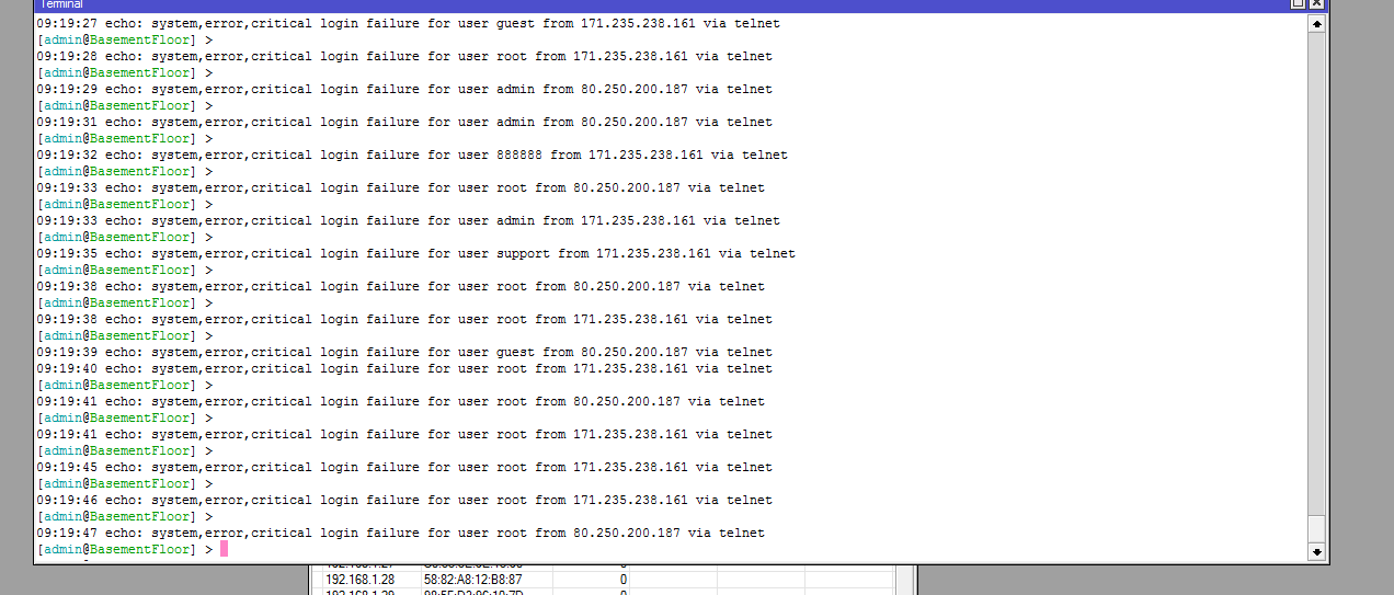

Also picture 1 shows the ips on the network and picture 2 looks like a bruteforce attempt on the network.
About the Telnet brute force, you must disable services which isn’t used, like API, Telnet…
/ip service
	set telnet disabled=yes
#OR via Winbox:
#IP > Services and disable that services.

The telnet attacks are from the wan. Check your firewall rules, you should have a default deny rule for inbound connections. Then only open ports as necessary. You do NOT need filter rules to allow incoming connections for ports that are forwarded with dst-nat.
The PC obtained an IP not from either of your pools. Maybe another Mikrotik still has the DHCP server enabled? With two DHCP servers on the same subnet, sometimes you’ll get a mix and match of settings from both DHCP servers, sometimes no gateway, sometimes no DNS…
The pool is wrong and have only one dhcp server running on Mainfloor and more one on Basement.
