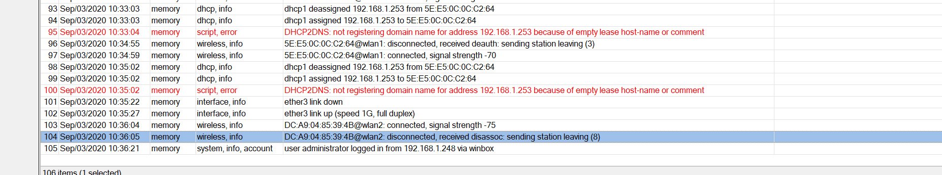

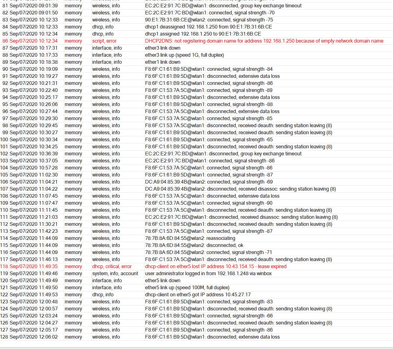

Installed new LTE6 SXT, no default config, config script as other my mikrotik’s.
Private client, 2nd MT is WAP AC as router and dhcp server, 2 PC, 2 applephone, 2 androids in the network.
1 month without problems and then appears DNS2DHCP error and noone have internet
then till hard reboot. < SEE ATTACHMENT >
I trying DNS resolving scripts, LTE interface watchdog, netstat, and many other things i used.

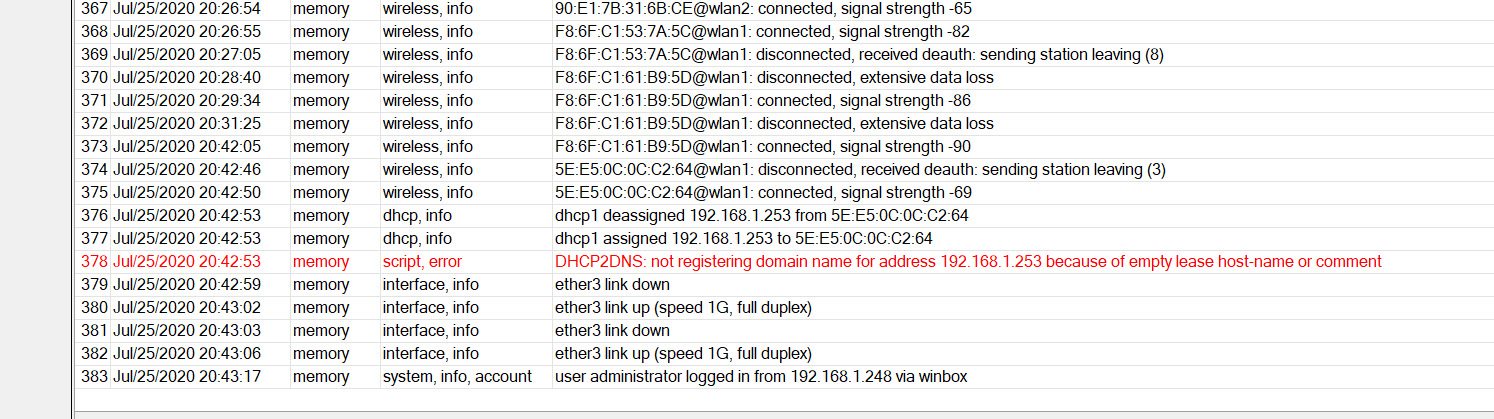

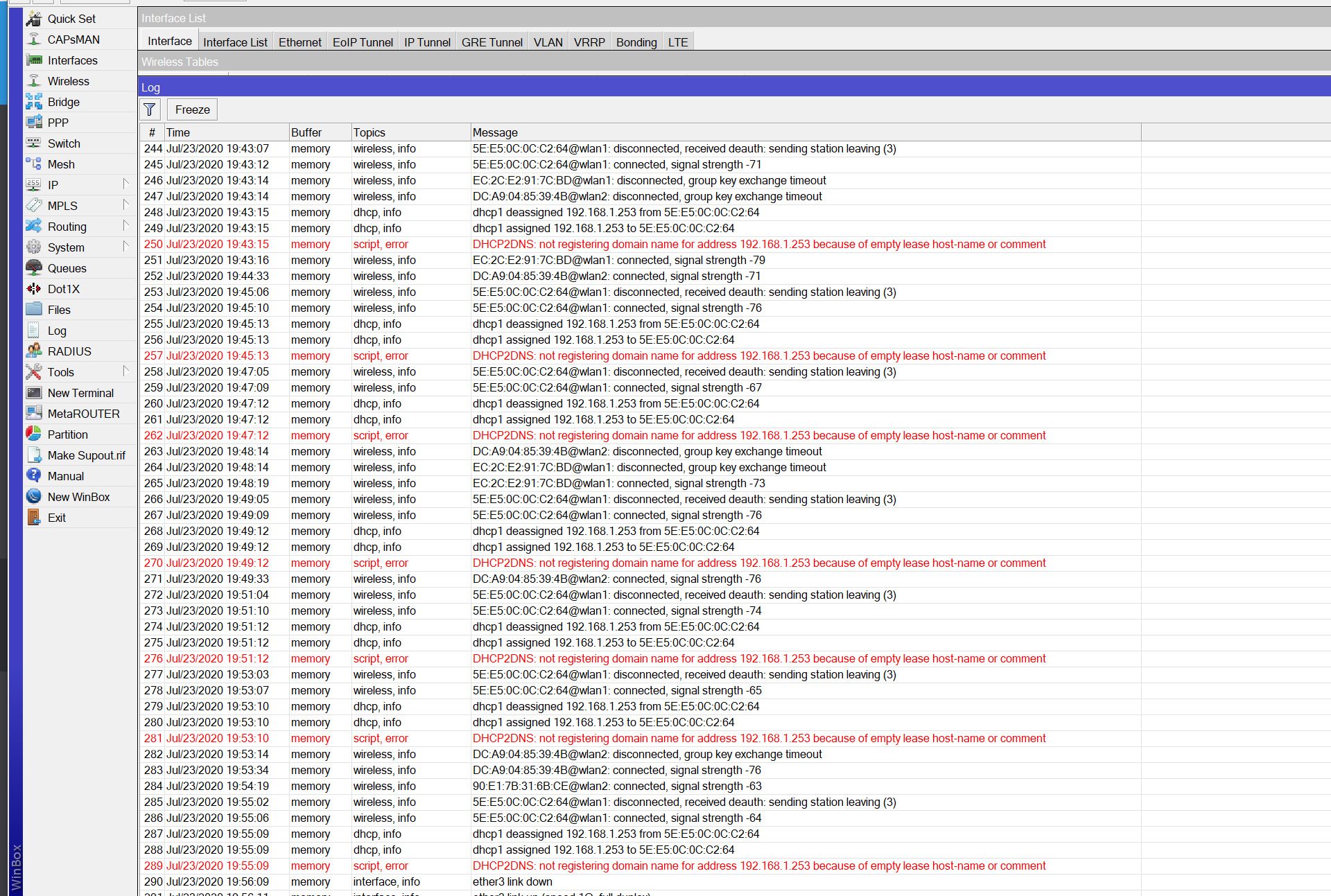

I think those log messages are a red herring. They are errors from a script, presumably you’ve added that script to the DHCP server. Assuming no errors in the script one of the log messages suggests that you haven’t specified a domain in the DHCP network, the other one just means a particular DHCP client hasn’t provided a host name. Neither error indicate that DHCP has failed, or that DNS won’t work.
Maybe remove the script at this stage, since it’s not working for you anyway.
In any case looking at the host that can’t access Google, either it’s DNS is set wrong, or the DNS isn’t working. We can’t tell which from a screenshot. Can you provide …
