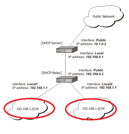

yep, have you set ‘Relay Address’ to 255.255.255.255 on DHCP Server?
how would i do that isnt it just the address of the dhcp server example 10.0.0.1 with dhcp pool of 10.0.0.0/8
http://wiki.mikrotik.com/wiki/Manual:IP/DHCP_Relay
The example is quite exhaustive, and works.
did that but nothing will it work with /8
Yes. Please post your configuration.

You don’t have the relay=relayIP option set in that server configuration as the wiki outlines.
Please erase all your configuration and follow the wiki guide I posted, replacing ONLY the IP address space used as well as the interface names. Leave everything else (including the object names) the same and check if it works.
exactly. if relay=0.0.0.0, your DHCP server won’t process relayed requests

is it possable to do this with out bridge
If you’re trying to attach the same IP space to two interfaces on the same router then you might be able to use VRFs (which will require a lot of reading), or you can bridge the interfaces and run DHCP on the bridge.
i dont want to do it on copper i want to do it on wireless and i dont want to use wds setup thats why i asked ill read up more and see what i want to do thanks for the help
then use EoIP tunnel and bridge it with your ethernets
