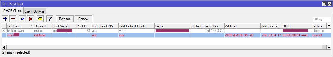

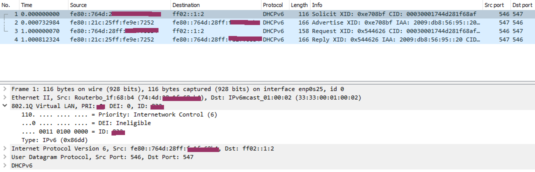

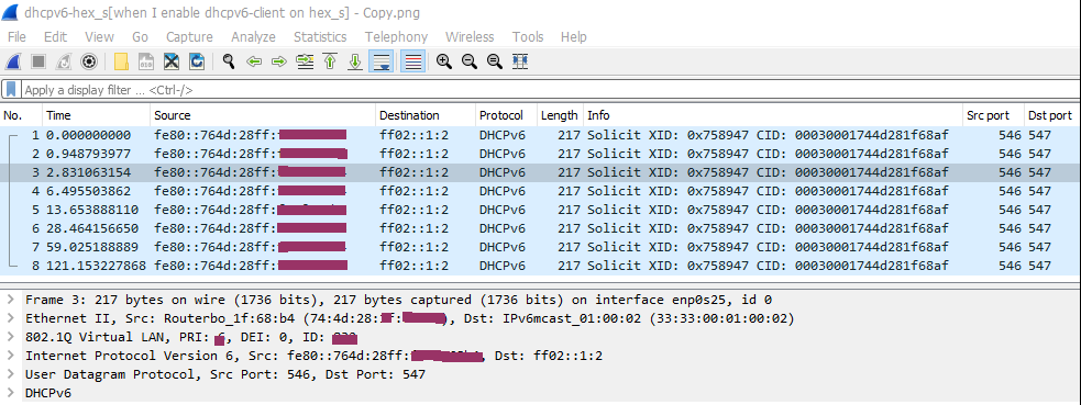

Hello @all,
Today i did a simple test to capture dhcpv6-client traffic from my routerboard Mikrotik hex_s (https://mikrotik.com/product/hex_s).
Router OS = 6.48 (stable)
1- i installed the dhcpv6-dibbler-server on ubuntu 20.04 (sudo apt update + sudo apt install dibbler-server) homepage: https://klub.com.pl/dhcpv6/
when it’s installed → modify the /etc/dibbler/server.conf to setup/configure the listening interface you want for dhcpv6 server function.
2- i installed the wireshark tool to capture traffic on my ubuntu 20.04 linux box (listening on the interface configured above) with the filter → udp portrange 546-547.
3- In the Mikrotik router i removed the sfp-fiber module and replaced it with a sfp-rj45 → Model Number: JT-C1GE-R01 (from JT-COM).
I did that to have a direct rj45 connection between the Mikrotik router and my linux box (unbuntu 20.04) running the dhcp server.
4- My dhcpv6-client configuration is in the following steps (physical interface sfp-rj45 + vlanxyz + bridge)
/interface vlan add interface=sfp1 loop-protect-disable-time=00:05:00 loop-protect-send-interval=00:00:05 name=VLANxyz vlan-id=xx
/interface bridge add name=bridge-wan
/interface bridge port add bridge=bridge-wan interface=VLANxyz
/interface bridge filter add action=set-priority chain=output dst-port=547 ip-protocol=udp log=yes log-prefix=“Set CoS on DHCP request” mac-protocol=ipv6 new-priority=x out-interface=VLANxyz passthrough=yes (x, xx, xyz, must be replaced by numerical of your needs).
/ipv6 firewall filter add chain=input comment=“allow dhcpv6 replies on WAN” action=accept protocol=udp src-address=fe80::/10 in-interface=bridge-wan dst-port=546 log=no log-prefix=“”

The traffic should appear very quickly as in attachment below:
You can see the first action “Solicit” coming from the router fe80::764d:28ff:xxxx:xxxx with a destination to the server ff02::1:2 (my linux box will answer in this case).
ps: I have not fully configured my dhcp-server config file to emule all my ISP mandatory behavior as this post is just for initiate the dhcpv6-client traffic in wireshark.
In a full working environment you shoud have at least tree more lines in the wireshark dhcpv6 client-server communication exchange:
  1. Solicit (client to server)
  2. Advertise (server to client)
  3. Request (client to server)
  4. Reply (server to client)

First capture is done on enp0s25 (the physical nic of my linux box/server side) → you can see the the frame: 802.1q for the vlan)
**[u]The second capture is done inside the vlanxxx → no more 802.1q[/u]**
![enp0s25.xxx.png|1075x261](upload://zxKgfkWSywvs4XXoq3pOofOCC7n.png)
The last capture is the testing bound satus that i got on mikrotik hex_s dhcpv6-client from my isc-dhcp-server
