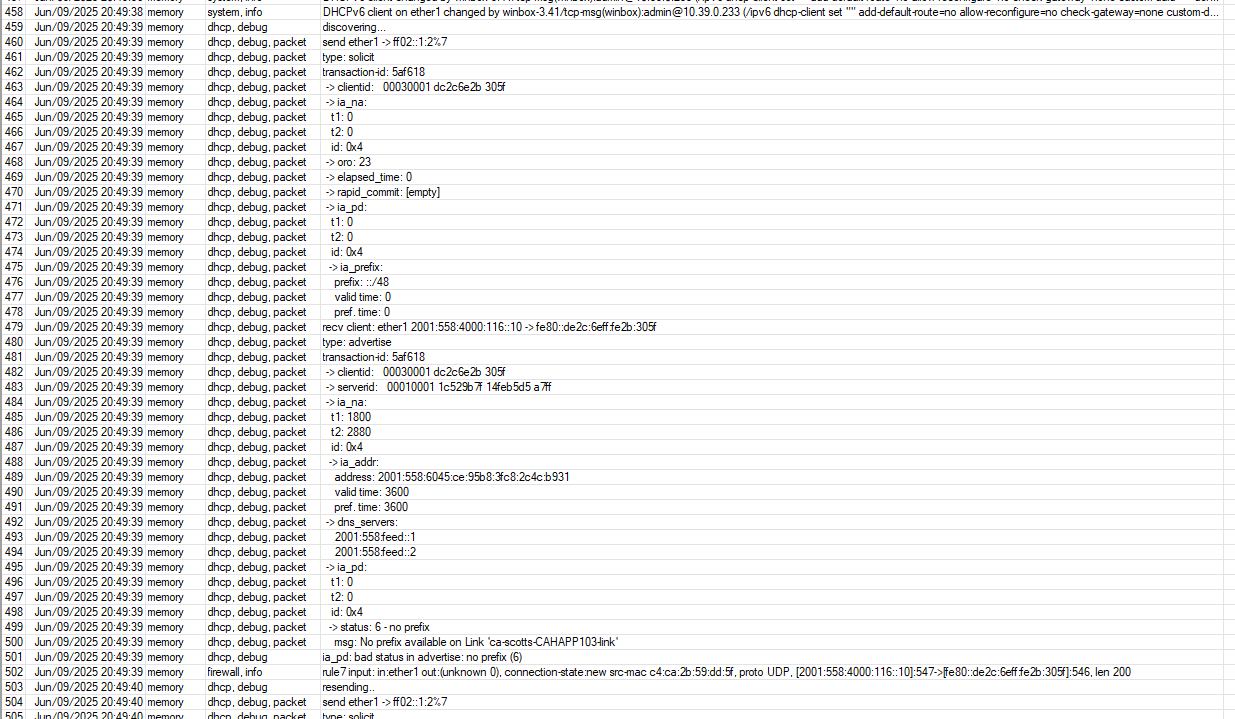

I have similar issue, it was working fine on 7.17.2 (with the firewall tweak), but the same configuration isn’t working on 7.19.1. I had to reset router because it ran out of space, then I reapplied the same configuration and then upgraded to 7.19.1.
I turned on debug log and find these messages:
  -> status: 6 - no prefix
    msg: No prefix available on Link 'ca-scotts-CAHAPP103-link'
ia_pd: bad status in advertise: no prefix (6)
So it seems like ISP just… has no ipv6 prefix to give me anymore?? Huh?
Oh well, I see that it is giving me an address, so at least I can do NAT.
