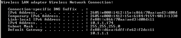

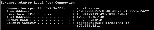

So I plugged the Win 7 machine into the modem directly..
ipconfig
and then into the router
I also tried just putting in the google IPv6 DNS directly into the network settings on the Win 7 machine. Still no go..
IPv6 is annoying..
So plugging in the WIn 7 machine directly to the modem works great. No issues. Can reach IPv6 site no issues.
Its entirely possible that Time Warner is doing something weird.. Well this is all good tho as im learning IPv6.

Yea weird.. Weird that a client on Win 7 can get allocated but not the router. They are getting really different addresses you can see from my screen shots from ipconfig.. Weird..
