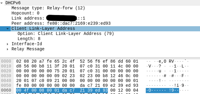

However, RouterOS does not seem to do this (see the attached screenshot).
RouterOS dhcp-relay seems to cut the last 48 bits of the link-local address and pass them in option79.
This is problematic since the last 48bits of the link-local address are in almost no cases representative of the clients link-layer/mac-address. However RFC6939 cleary states that the link-layer address shall be used. The highlighted area in the screenshot show the nibbles
 da c7 21 39 ed 93
which corresponds to the clients link-local address.
My mac-address in this example is completely different from what RouterOS includes.
This should be fixed to allow people to properly use option79 :slight_smile:

In my case, I have a client with a mac address of 52:54:00:b2:c5:50 and a mac-derived link-local address of fe80::5054:ff:feb2:c550. For the dhcp server, I have dnsmasq using the dhcp-host option to match the mac address of the client. Looking at the traffic passing through the relay, I can see that the mac address being sent in option 79 is actually 50:54:00:b2:c5:50 instead of 52:54:00:b2:c5:50, which reflects the same behavior that JayDi described. Since the mac address that dnsmasq sees does not match the client, it returns a “no addresses available” message.
For the sake of comparison, I set up a dhcpv6 relay using a Cisco CSR1000v image and relayed the same client and I could see that 52:54:00:b2:c5:50 was showing up correctly in the packets and dnsmasq was able to offer the client an address.
Even if we’re assuming that the link-local address is coming from the mac address, I believe the number represented by the first two digits to the right of the “fe80::” (50 in this case) needs to be XOR’d against 0x02 to return the correct value of the most significant byte of the mac address (52) - that would be a pretty easy fix that would at least support any devices deriving their link local addresses from their mac address.
