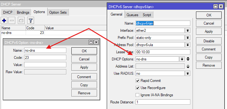

Yes, currently when you use the DHCPv6 server in RouterOS it will pass the list of IPv6 addresses in dynamic-servers to the DHCPv6 client with no switch in setting to disable that. This is how I workaround the issue on my lab installations:
/ipv6 dhcp-server option
add code=23 name=no-dns
/ipv6 dhcp-server
set [find name="your_server_name"] dhcp-option=no-dns
After doing this only the DNS setting advertised by the /ipv6 nd entries will be used by the clients. The DHCPv6 server will only send an empty DNS server list (through the overridden option 23).
