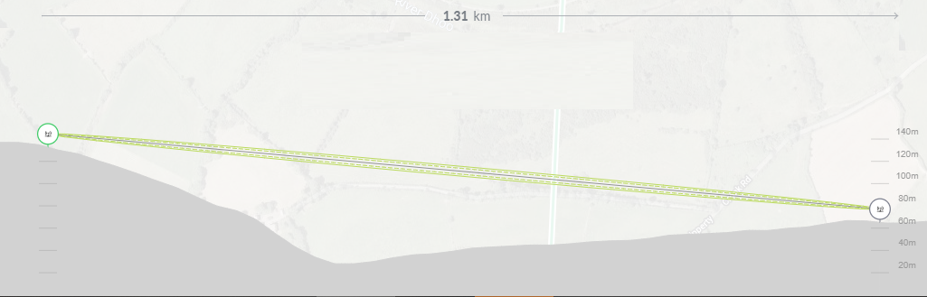

I live on a farm with line of site to cell tower, 1.3KM away. Mounted on antenna mast, on 2nd story, pointing at tower, I am getting 17Mb download and 4mb upload.
There the tops of a handful of large tree between us and tower, but still results are terrible. While on the roof, I was getting 45/20 on my cell phone.

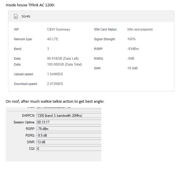

RBSXTR&R11e-LTE On roof pointing at Cell Tower:
SNR: 8-12
17/4Mb
TP Link ac 1200
SNR: 20
45/20mb
Should be the correct LTE device. SNR is very low. Using the same frequencies (band) as the other router?
My experience is getting -80dBm RSRP , where the inhouse unit gets -105dBm.
Please see attached results:
Same channel, seems like different planet :frowning:
Is the Tik LTE connecting to 3G or 4G, turn off 3G on the device
While RSRP (it’s the cell’s signal strength) difference between indoor (-93 dBm) and outdoor (79 dBm) is sensible one, it’s RSRQ (signal quality) which is rather low. If it was the unrelated noise, tgen RSRQ should be lower (i.e. more negative) when RSRP gets higher. But the fact that RSRQ remains the same (assuming receivers in both devices are of same quality) indicates that interference is directional and coming from the same general direction as 4G signal. It could be self-interference (trees and other “small” obstacles on the signal path can cause signal scattering which can show as increased interference) and that us very hard to diagnose without using specialized measurement equipnent (e.g. spectral scanner capable of decoding QAM modulations and OFDM and LTE signals).
Maybe Maybe you get better results with another band, with lower RSRP reception level, but better RSRQ. (SXT TE kit lets you indicate allowed bands for connection)
