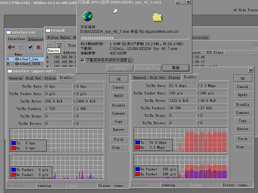

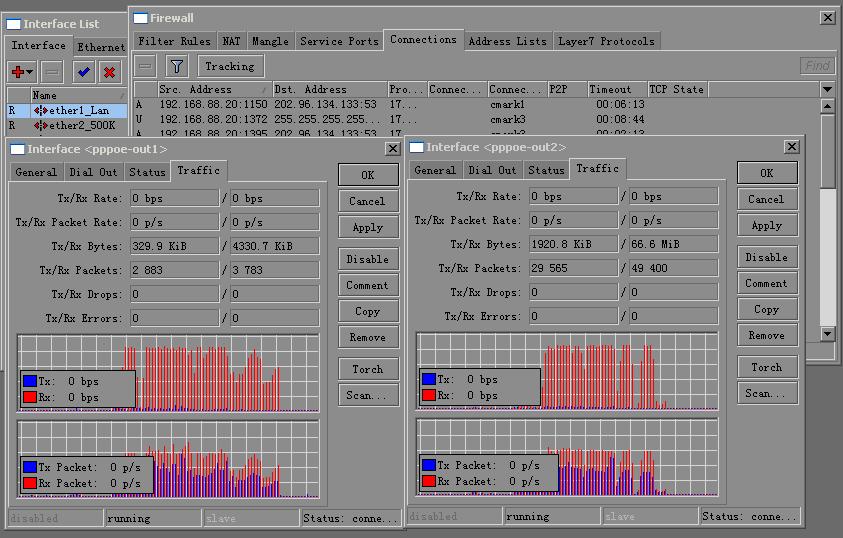

but when I browse the webpage, it seems work perfectly shown in tcp_webpage.jpg, But when I download files or visit webTV it seems unworkable like what it shown in tcp_download.jpg. Did I do the correct NTH load balancing?
I found that when download or visit webTV, only one connection shown in “firewall connection” submenu,when browse website,it shown several connections, so I consider that this “NTH” load balancing just is a “per-conncection load balancing” like PCC rather than “per-packet” load balancing,is there a real “per-packet” load balancing.Thanks
