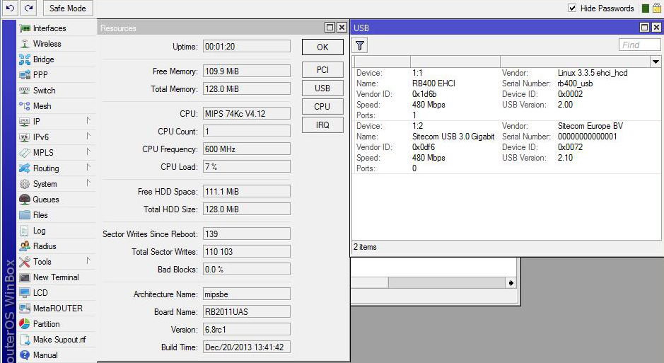

Sitecom LN-032 V1-001 USB 3.0
This adapter works NOT :frowning:
Try RouterOs 6.7, 5.26, and 6.8rc
So, Sitecom= black list :confused:

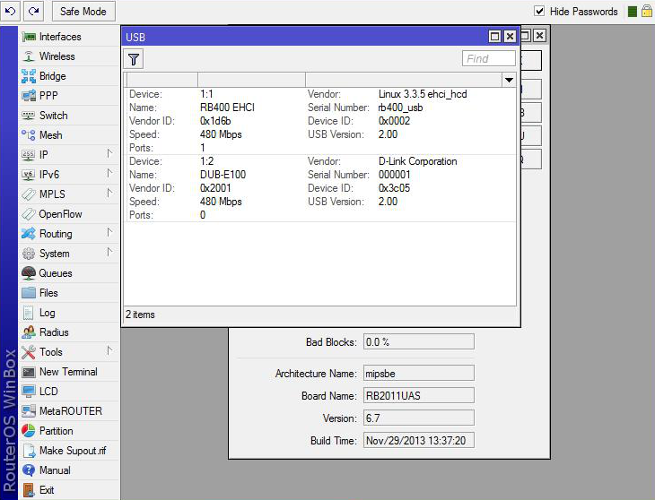

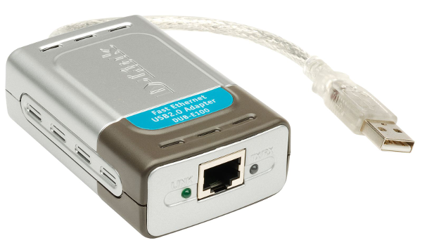

The D-link DUB-E100 works fine.
Plug in and thats all
Tested on rb 2011 UAS-RM and RouterOs 6.7 and rb 751G-HnD with RouterOS 6.7

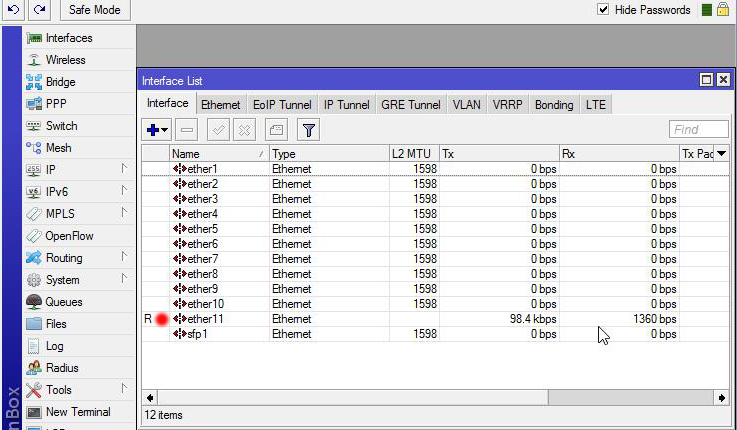

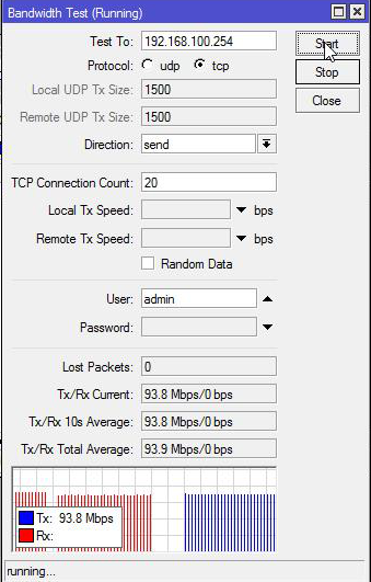

Have you tested the Dlink with the BTest on local network to see the max data rates ??
Yes i tested with D-link see printscreen
