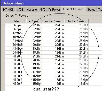

Hi, I found a question to make the link calculation with mikrotik, eg, in calculating mikrotik link (http://www.mikrotik.com/test_link.php) or otherwise, asking for the power of transmision.The question is: What power I put of all the power contained in the Current Tx Power window. As default mode, there are various powers under the Rate?. In addition to which there is a Tx Power, a Real Tx Power and a Total Tx Power. What Power do I use of them?
If someone is very clear, the questions are:
  1. The difference between:
    -Tx-Power:
    -Real Tx-Power:
    -Total Tx Power:
real tx power is single chain power and total is dual chain power, real+3dbi=total
It doesn’t add up:/
real tx power is single chain power - ok
and total is dual chain power - so total is 2xreal?
but then you saying that total is real+3dbi (from where did you get this 3dbi?)
may I ask you to clarify?
20dbm+20dbm=23dbm
20+3=23 is for beginners
Yeah, dB’s are logarithmic units. Convert them to mW to actually compare in linear scale if you like..
