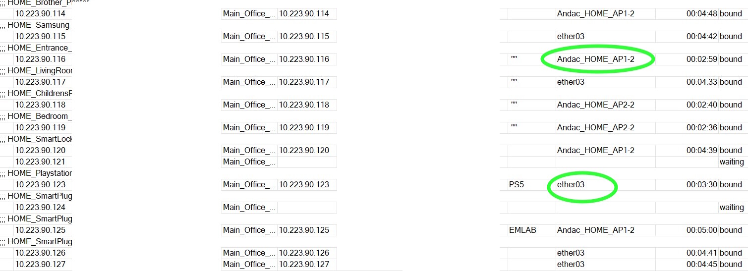

I use Wireless CapsMan (the old one) with the RBwAPF-5HACT2HnD access points in my RB5009UG+S+ router. The devices connected to these access points visible under the IP → DHCP Server → Leases with their “Bridge Port” are displaying which access point and which channel of the access point the devices are connected to.
However, when I use WiFi CapsMan with the cAP ax access points in the same router, the devices connected to these access points are displaying under the IP → DHCP Server → Leases their “Bridge Port” as the port where the final connection of the access points are connected to on the router, for example, ether03, instead of the particular access point name and channel.
Screenshot showing both cases attached.
The former version of things was more informative and helped diagnose issues when they happen. Is there a specific setting to get the former details under WiFi CapsMan or is the new one built as it is and no details will come to the Bridge Port section under DHCP leases?
Thanks in advance!
When using old CAPsMAN, do/did you use capsman forwarding in datapath? It doesn’t exist in new (wifi) CAPsMAN …
Yes, I did. That explains it then. Thank you.
