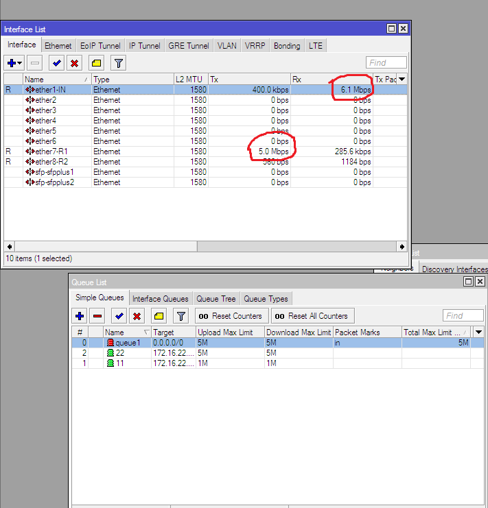

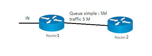

if we have the below scenario in the first attached picture
when router 2 reach its maximum limit ( 5M ) the IN interface traffic is about 6 M or more if router 2 has high number of connections
so if I have customer with band 5M , it costs 6 M in reality ( see the second attached picture )
is there a method to treat this loss in bandwidth ?
That’s correct. You cannot force anyhow the server sending udp packets to slow down them according to your wish. It just sends what it wants and you are dropping the packets that overflow the quota…
