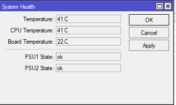

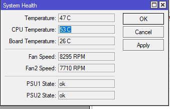

Three years later I arrive at this thread with a similar problem on a CCR1016-12S-1S+. It has two fans which literally vanish from the System Health window on winbox. Then they reappear at 4000RPM ramping quickly up to 8000 then vanish again.
I’d suspect a hardware failure but the only official answer is a driveby correction post from a Mikrotik employee. I keep buying these plastic routers thinking it’ll be different this time. :neutral_face:
