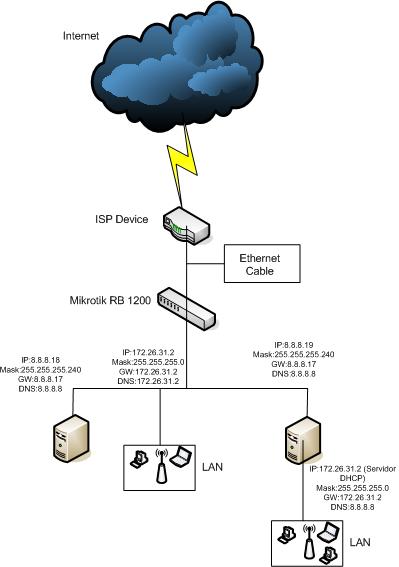

Ok, I’m attaching in the post a Diagram to better understand.
In resume, I have an internet connection I want to connect to my RB1200 and I want to use the other ethernets in RB1200 to connect servers with public IP. In the Diagram I attach it’s an example what I need:
Eth1: Connect my WAN connection
Eth2: Connect a server with a public IP
Eth3: Configure a DHCP server in this interface and make NAT to connect internet.
Eth4: Connect another server with a public IP
If I configure a NAT rule with masquerade (chain=srcnat action=masquerade), the Eth3 works fine. I want to configure Eth2 and Eth4 to use my pool of public IP (I don’t want a correspondence Eth2 with IP 8.8.8.18, I want to use each public IP I have in Eth2 or Eth4).
Nowadays I use a switch instead of RB1200, but I can’t control the bandwith of each public IP (for example, In my 10Mb internet link I want to restrict 2 Mb to Eth2, 3 Mb to Eth3 and 5Mb to Eth4).
Thank you for your help!
Rene
The diagram does not show how the public IP range is being delivered to you. Is it:
A) Being routed to you via a link net - e.g. routed to 172.26.31.2
B) Simply presented on ISP connection which assumes that X.X.X.X/28 is available directly on the connection to the ISP
Remember - you can use a bridge/switch within a subnet but once you insert a router you have split the subnet and for true routing you would typically further sub-divide the subnet so that everybody’s view of the subnets are the same (i.e. is it a /24, /25, /26 etc.). Further splitting the subnet does tend to lose usable IPs.
You can play all sorts of tricks to work around such problems but in some ways NAT would be easier to implement and support.
The Public IP range is 8.8.8.18-8.8.8.30 - Mask 255.255.255.240 - Gw 8.8.8.17
The answer to your question is
“B) Simply presented on ISP connection which assumes that X.X.X.X/28 is available directly on the connection to the ISP”
Tks.
OK - so the ISP expects the whole subnet to be directly visible in broadcast domain associated with their interface to you. That makes it very difficult to split some IPs out and place them on devices attached to other interfaces of the RouterOS device because you generally can’t split a subnet with a level 3 router like that.
