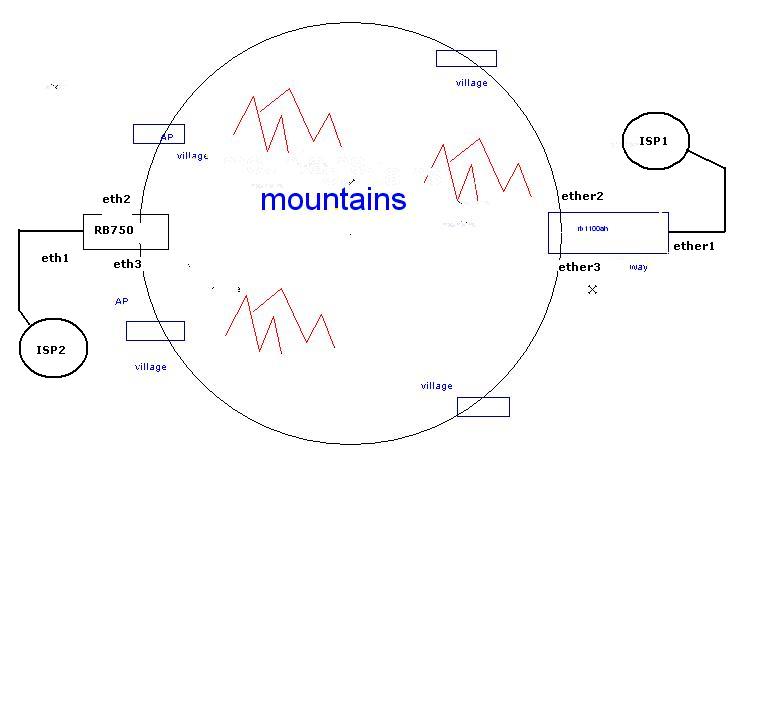

see attached
The ring is currently configured as 1 network back to 2 seperate interfaces on RB1100ah,
Now, the RB750 needs to be modified (halfway in the ring) so that
village 1 or subnet (xxx) goes out through ISP2 prefered, but if ISP2 fails, then their traffic will go to ISP1.
Similarly all traffic that was destined for ISP1 (main) will fallback to ISP2 if ISP1 fails
OSPF Cost would accomplish what you want and get the villages to take the default route nearest to them if you have routers at your towers/APs.
But using OSPF cost to engineer traffic can get ugly quickly. On the upside however, it is relatively simple to configure. If you need more granular traffic control, BGP is the way to go.
Check out these from the Wiki
http://wiki.mikrotik.com/wiki/Manual:OSPF-examples
http://wiki.mikrotik.com/wiki/Manual:OSPF_Case_Studies#OSPF_Operation
If I understand the question correctly you are essentially adding a second ISP gateway to the ring. You seem to be satisfied with the current OSPF solution so I suggest that you stick with it and simply use the OSPF interface cost feature to make certain ring members default to Gateway A while others default to Gateway B. OSPF is perfectly adequate for this topology. The redundancy for ring breaks will be maintained.
With some gateway checking and possibly some additional Netwatch/Scripting you should also be able to detect ISP failures at the gateways and alter the advertised default routes accordingly thus giving you ISP failure redundancy too.

Look at interface cost in OSPF. By adjusting interface cost you can ensure that a particular point on the ring will tend to use (say) Gateway A rather than Gateway B unless its direct path to Gateway A is broken.
To see the cost that a given point on the ring is seeing for the default route(s) look in Routing / OSPF / Routes. Those effective costs affect which routes OSPF places in the main IP routing table.
If you only have dynamically created interfaces in OSPF (created because of network entries) then manually add the interfaces - the dynamic ones will disappear and you can manually set the OSPF cost associated with the interfaces.
