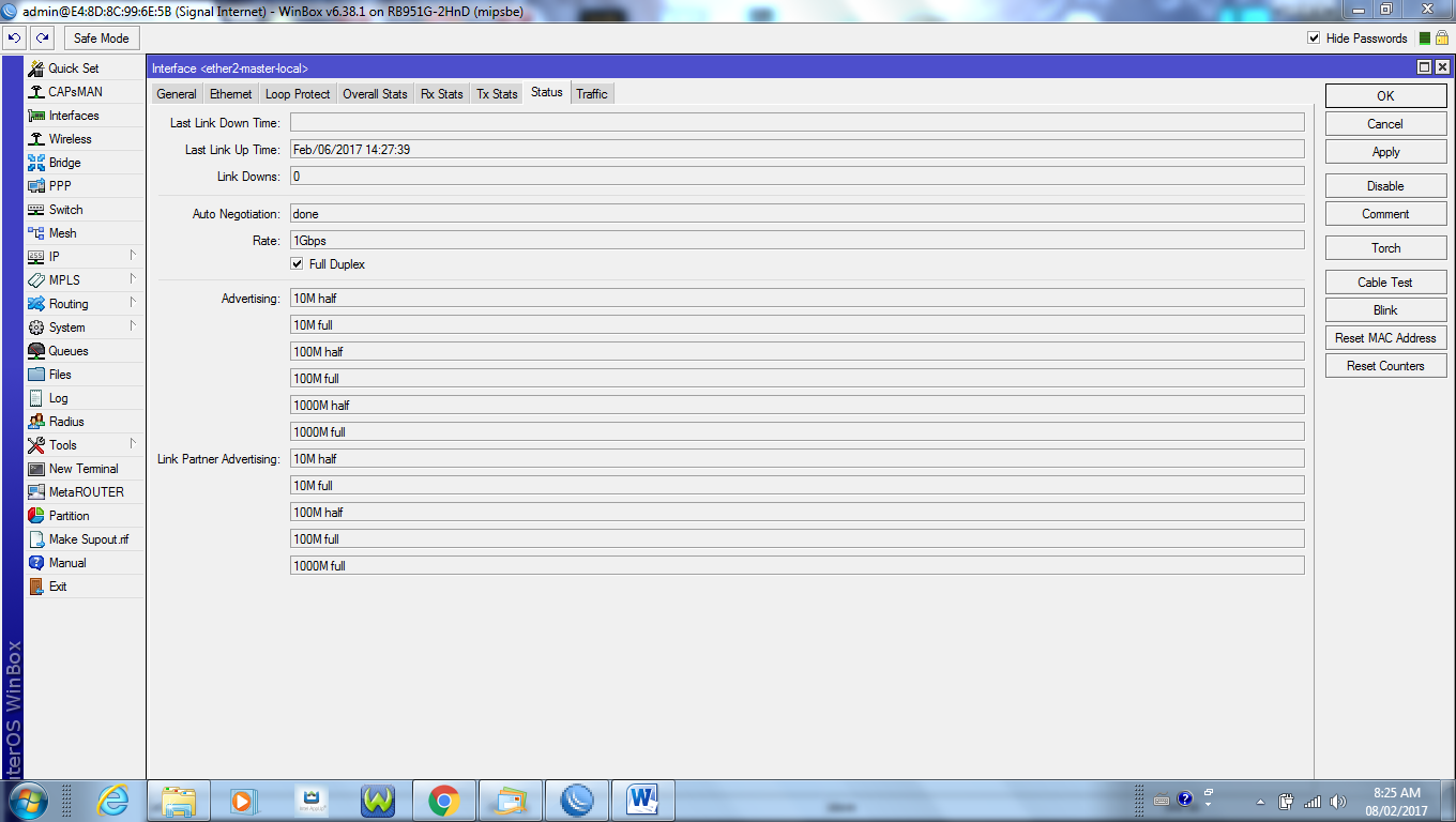

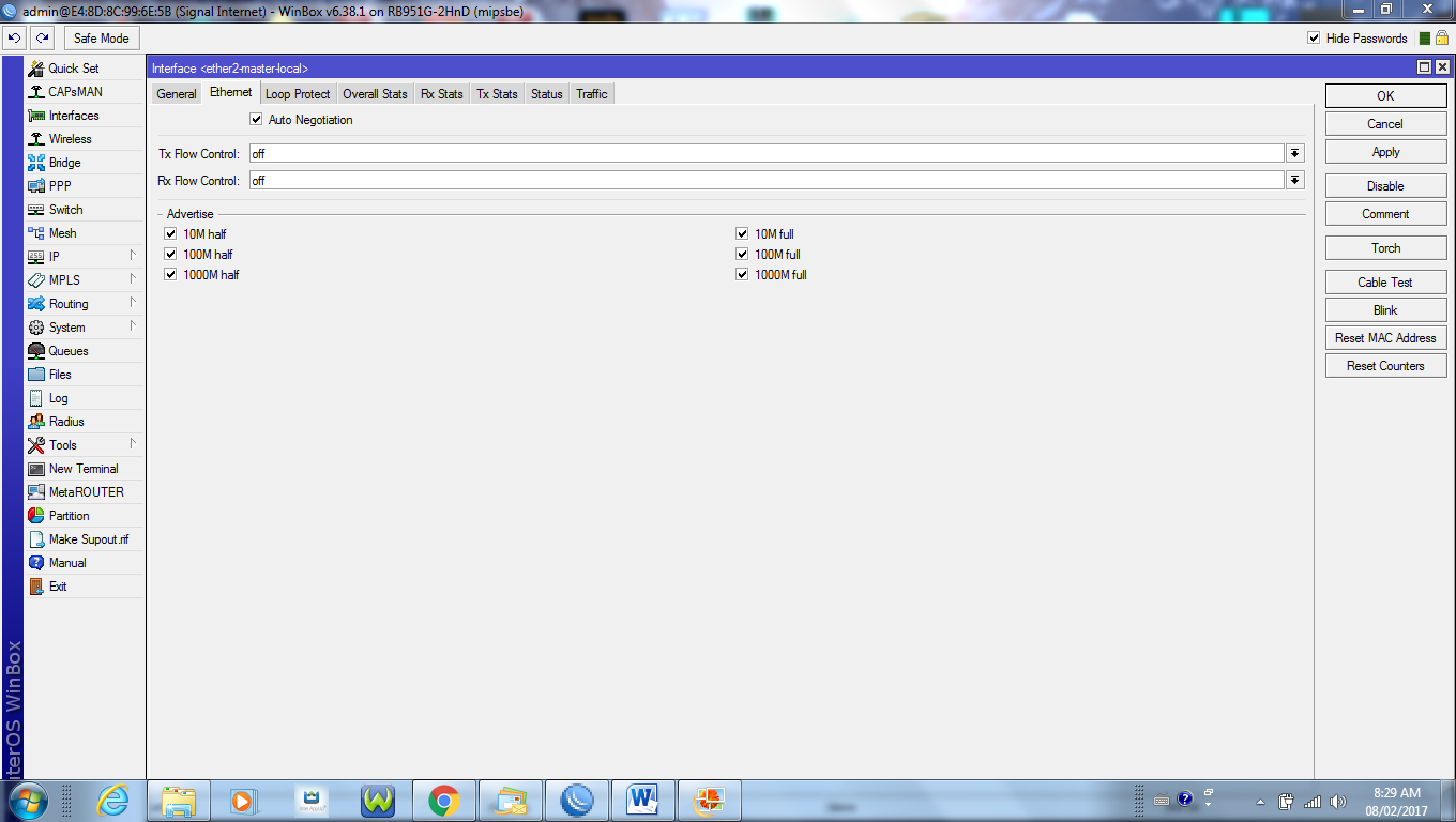

what service you running on the RB. can you post screen shot of status page of port connected to switch also config page of port.

interface-ethernet 10,100,1000 half and full is checked off is all check off and the status-rate 1gbps is checked off.
i hope these screen shots help
