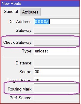

Yes you do!!..
Its similar… the only difference is that one doesnt create a table with a separate Table rule, one simply uses routing-mark in the route itself
dst-address=0.0.0.0/0 gwy=ISP1 distance=5 check-gateway=ping
dst-address=0.0.0.0/0 gwy=ISP2 distance=10
dst-address=0.0.0./0 gwy=ISP2 distance=10 routing-mark=useSecondary

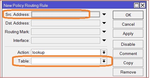

Route Rules are found in IP Routes as another tab selection at the top and one enters them like so (same as before really).
add src-address=IP1 action=lookup table=useSecondary
and so on…
In other words, the only real difference is
a. dont create a table.
b. use Routing Mark in the Route
c. refer to the Routing Mark in the Route rule via the Table designator/parameter in the Route Rule.
