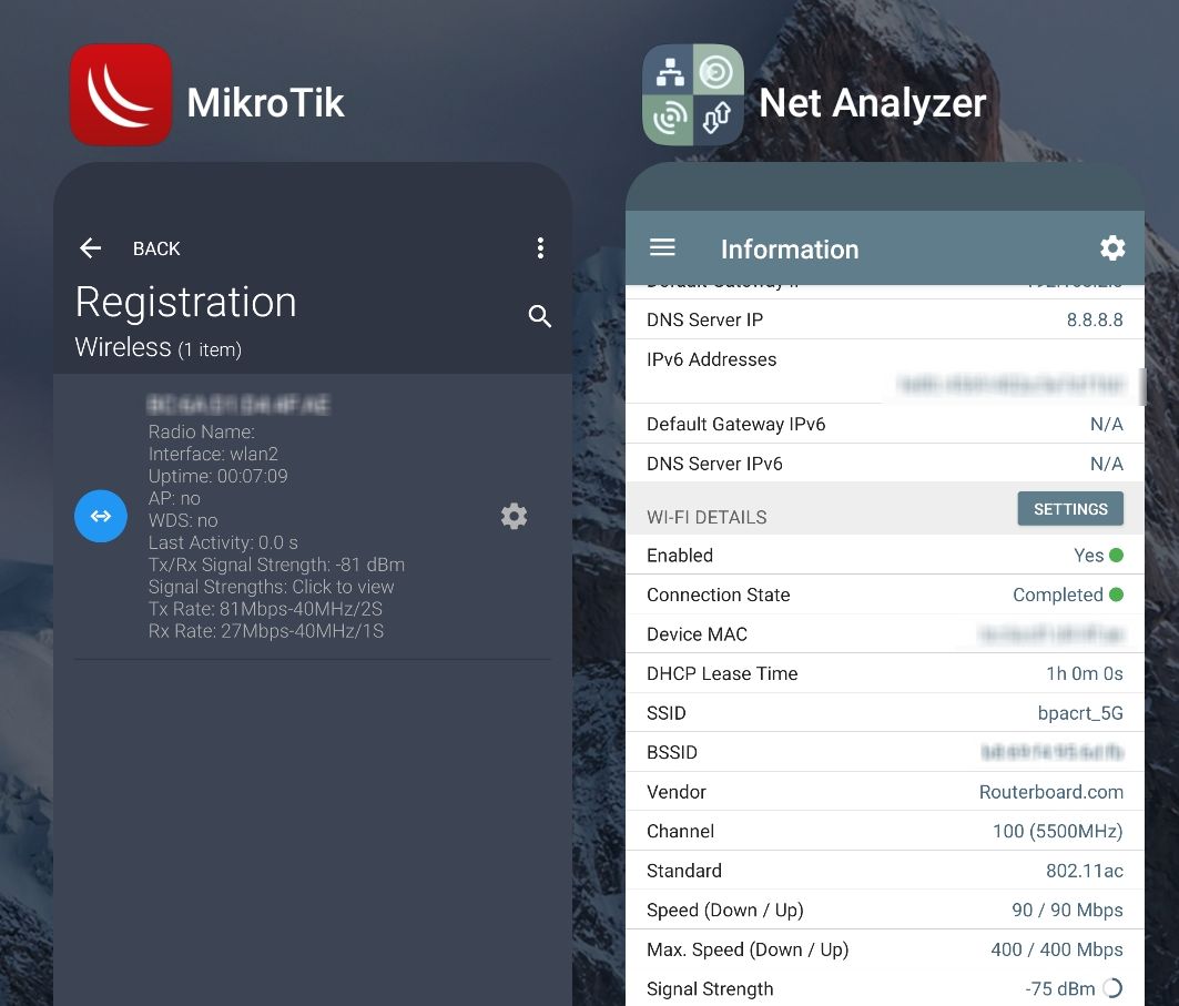

Smartphone signal comes in at -86dBm on wAP ac. Just a bit too weak to be stable.
wAP ac is received at -73dBm by smartphone.
Already selected the 5GHz channel with highest allowed EIRP in ETSI region.
Hope to receive smartphone better.
(smartphone is moved around, and can be shielded by body or hand).
Fluctuates strongly, even both measurements on the screenshot out of sync, but that’s the way to look at it. (Mikrotik client (station) would have given all information in the MT AP)
Remote AP (SXT PtP link + Client AP) would be much better , but requires power at the remote AP).
