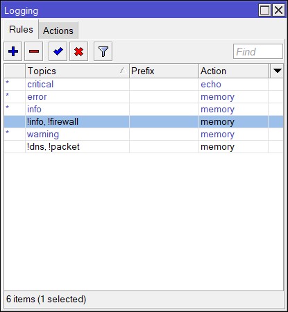

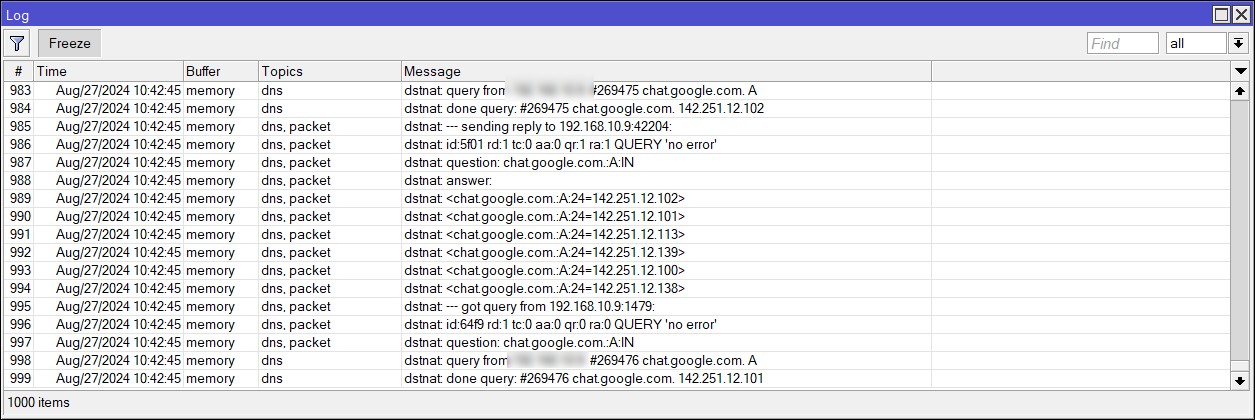

Hello, How to stop logs from dns topics, packets like in the picture. Hopefully friends can help me. Because this log causes unnecessary logs to be full.
I have tried the configuration as in image 1 but there is no effect on image 2.

Hello! You have to define the topic DNS without “!” because this excludes DNS too, the topic of wich you want to disable logging.
A working topic should look like this:
dns, !info, !packet, !debug
