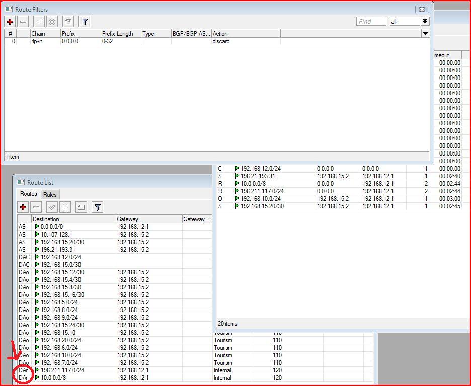

As simple as this seems it’s not working.
As you can see Ive attempted to make a test filter that should in theory dump ALL routes RIP coming in.
However if you look at where i circled rip rules are still being added.
Something stupid?
On your rip peer / interface do you have in-filter and out-filter specified ? You have to tell it which /routing filter chain to associate with.
Also, if you want to reject all routes just leave off prefix and prefix-length and just use action=discard.
Sam
Thanks, got it working…
