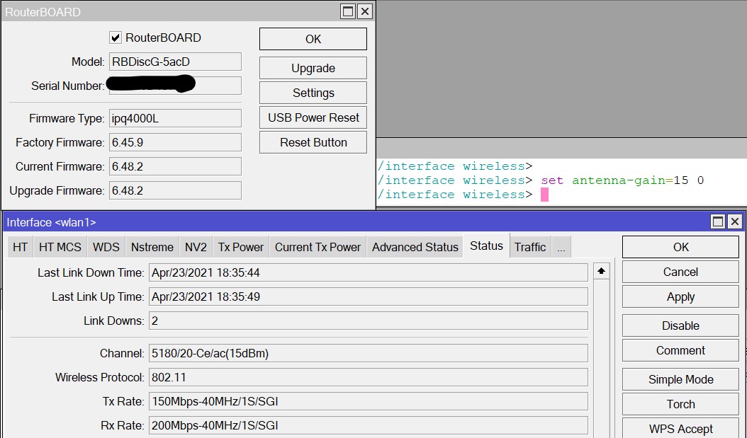

What you are saying is flat wrong. I have multiple Disc5AC Lite units, fresh out of the box just installed a few days ago, running 6.48.2 with firmware to match and I can change the antenna settings no problem. With it at the default of 21, output is locked at 9. If I change it to 15 gain then the radio outputs at 15. The Omnitik AP also sees the increase in signal so this is actually happening, it’s not cosmetic. If I change the antenna to 0, the radio screams out 30dB and modulation drops massively just like you’d expect. ie, the antenna setting is functional on new hardware on the most recent software and firmware.
No, the USA3 setting being locked appears to be true, but an error. This should allow 36dB in PtMP and 42dB in PTP in U-NII-1
screenshot of that?
first ac device to show output power on current tx power?
Here it is. No changes made to tx power. The 15dB output is a direct result of the antenna-gain=15. If I change gain to 14, output goes to 16 and so on.
