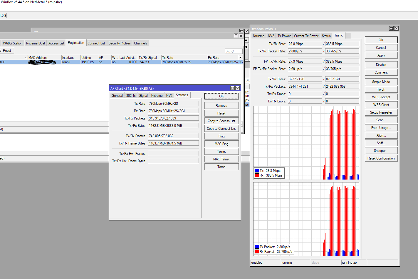

Below is a shot of a NetMetal running Ceee AC with connect speed (air rate) of 780Mbps/780Mbps showing actual data throughput of approx 390Mbps - data rate being typically half air rate. Tx/Rx signal on this link is -50dBm and protocol is NV2. I’d compare with 802.11 but it is a production link and I cannot make changes.
These NetMetal’s are connected to mANT30’s (with Sleeve) and running on a 5Km link - the mANT30 is being used as it is an urban to rural link and we want to reduce interference so to compensate for the extremely high gain aerials we reduce the TX power of the Netmetal to achieve -50dBM. The mANT30 & Sleeve reduce side lobes and interference from behind - this improves the SNR.
